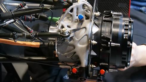

One key component selected for lightweighting was the uprights. These components connect several sub assemblies in the vehicle, enabling the transmission of wheel motion to the suspension arms and subsequently, to the shock absorbers. All four uprights in the vehicle house an electric motor, and act as supports for the planetary gear system contained in each wheel. Using AM for the uprights would enable the team to reduce the vehicle's unsprung mass, improving control over its dynamic behavior.
For previous vehicles, the uprights were machined from 7075-T6 aluminum on a 5-axis CNC milling machine. For the new vehicle, the team came up with an organic-type geometry that required a different manufacturing process.

The development of the new uprights enabled the team to achieve a significant weight reduction for both the front and rear uprights - 30 per cent and 28 per cent respectively. This decreased the vehicle's unsprung mass, resulting in better control of the vehicle's dynamic behavior.
The team was able to meet the competition's compliance criteria by reducing camber compliance by 18 per cent for front uprights. Furthermore, the additive manufacturing of the uprights enabled the team to reduce upright material use by 45 per cent.
