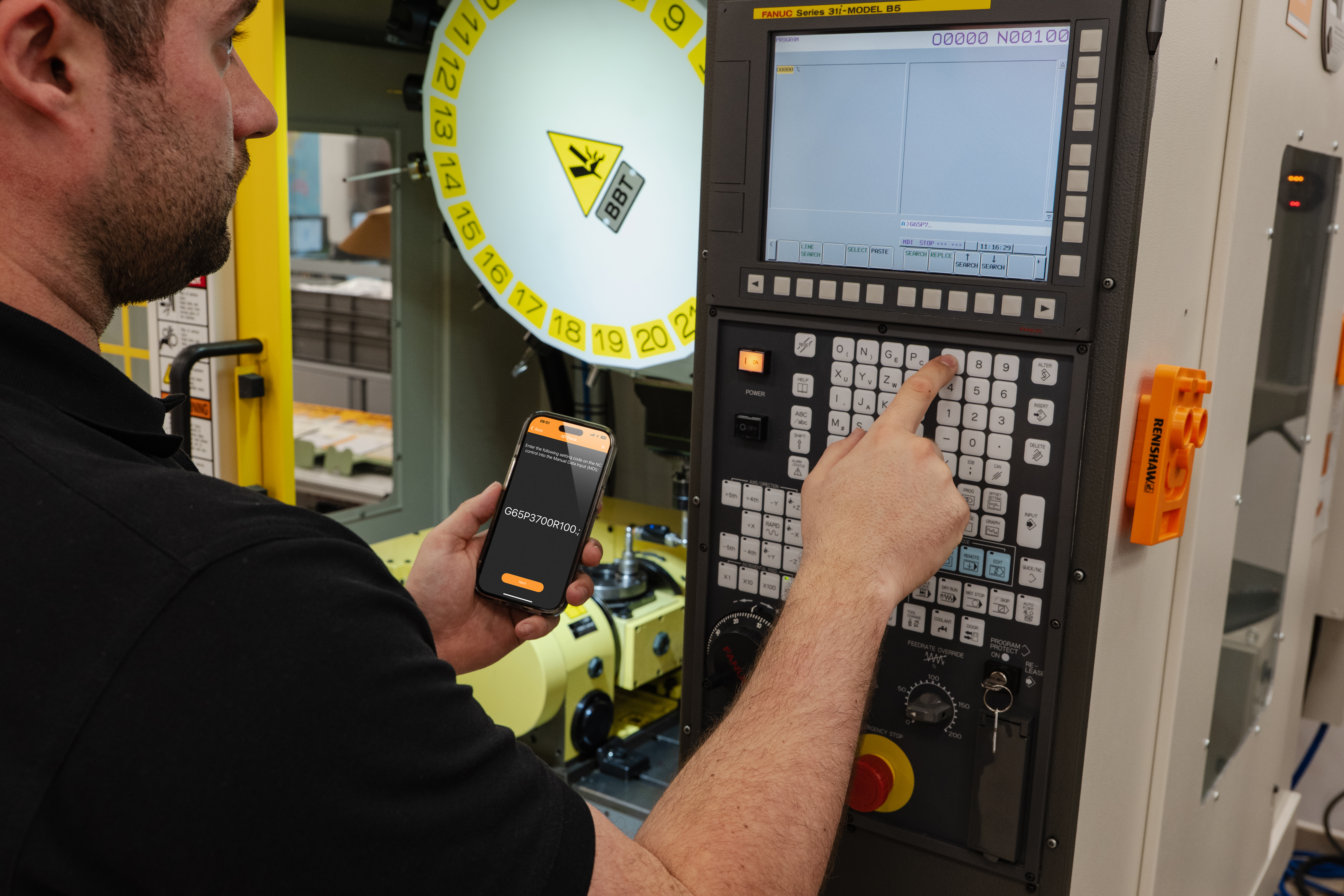

The CARTO Ballbar Connect app uses a macro-based program, offering maximum simplicity to customise a setting code to configure and run a ballbar test, whilst removing the requirement to edit and transfer machine part programs. The CARTO Ballbar Connect app allows a user to easily set-up and capture data from the QC20 ballbar in one test sequence. Machine results are provided as a single quantitative, visual indication of the machine's volumetric positioning performance using the app's 3D Check test sequence.

Machine operator inputting G-code from CARTO Ballbar Connect app into machine

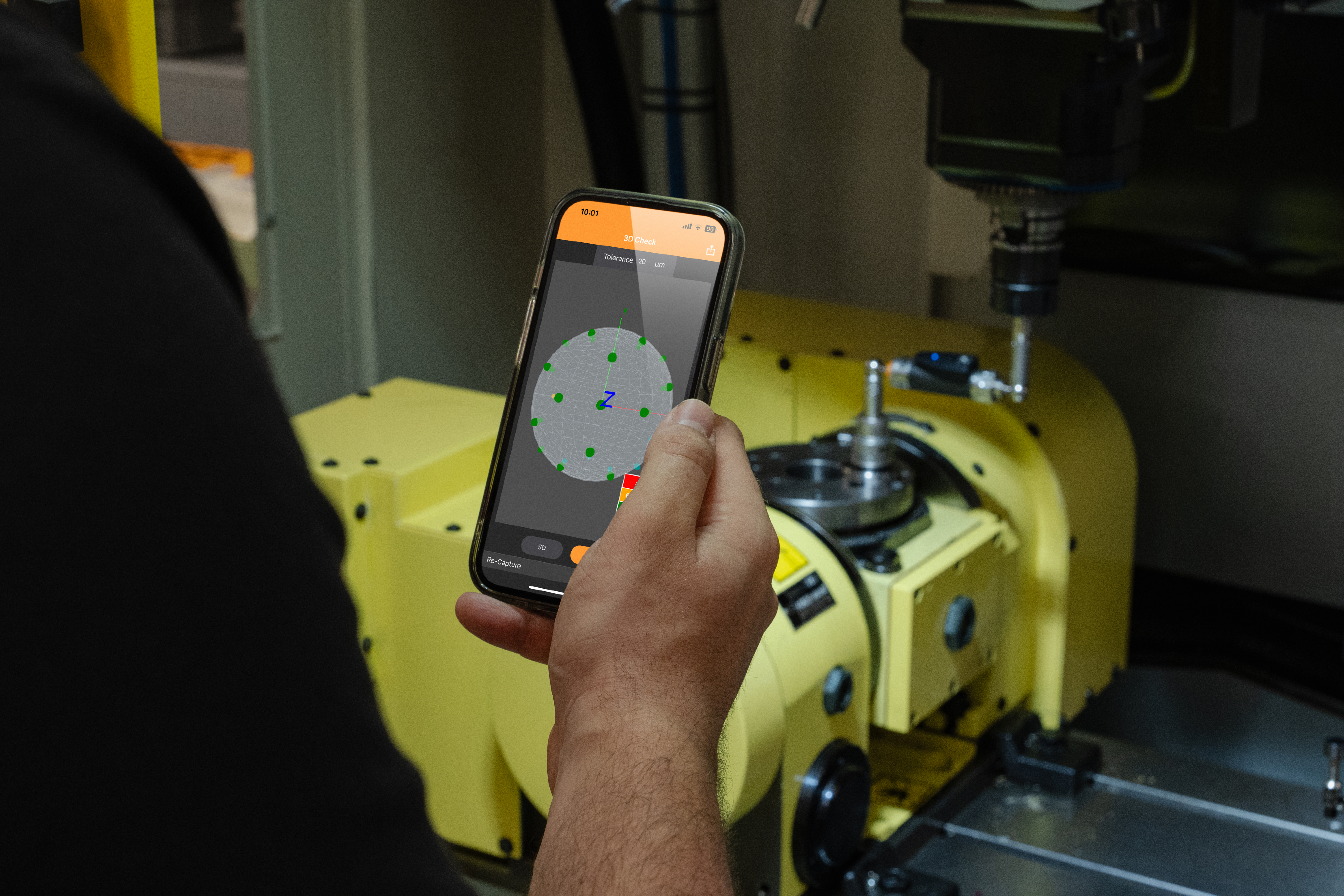

Hand holding mobile device displaying spherical deviation in CARTO Ballbar Connect app, with QC20 ballbar in background

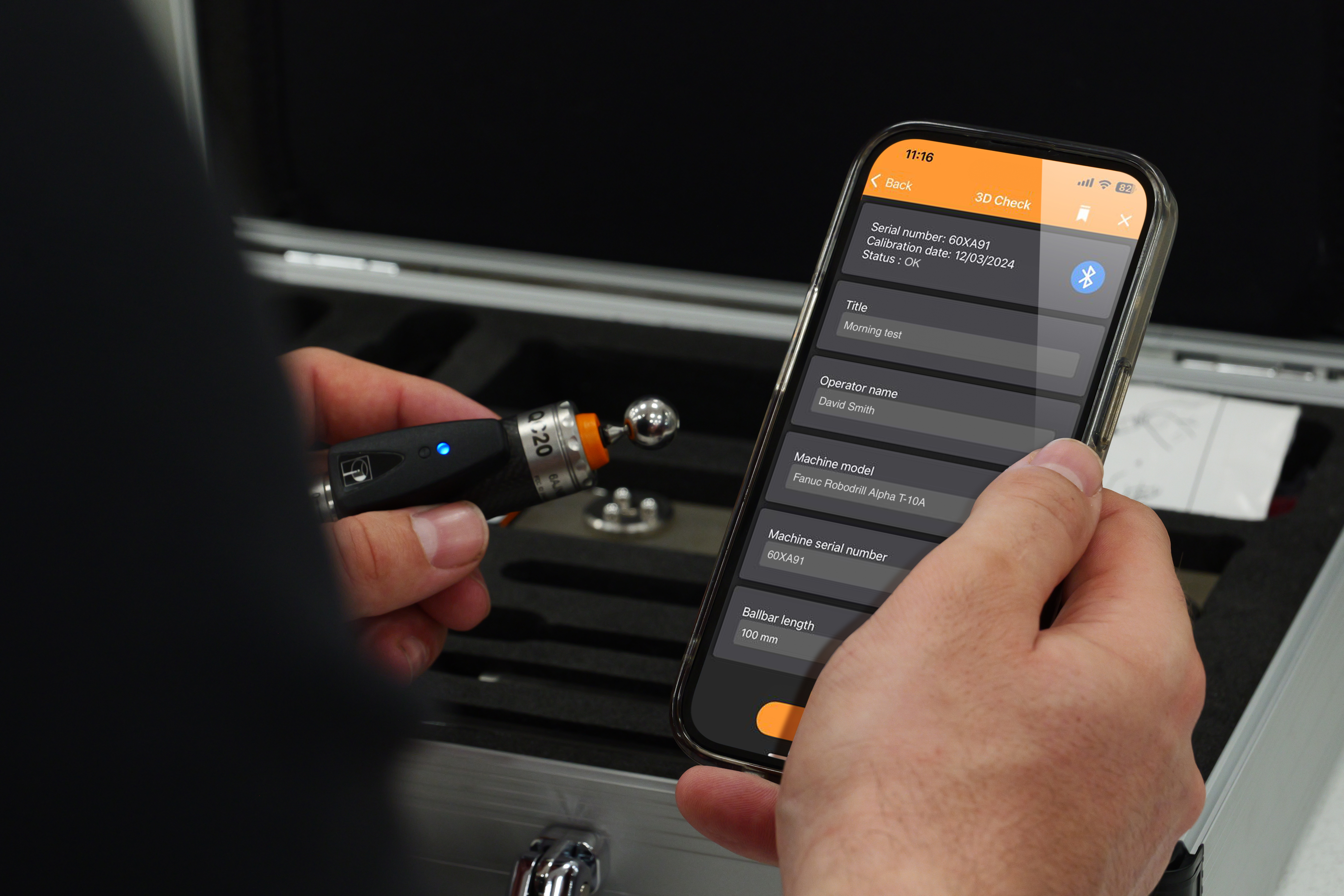

A hand holding mobile device displaying set-up screen of CARTO Ballbar Connect app and other hand holding QC20 ballbar
