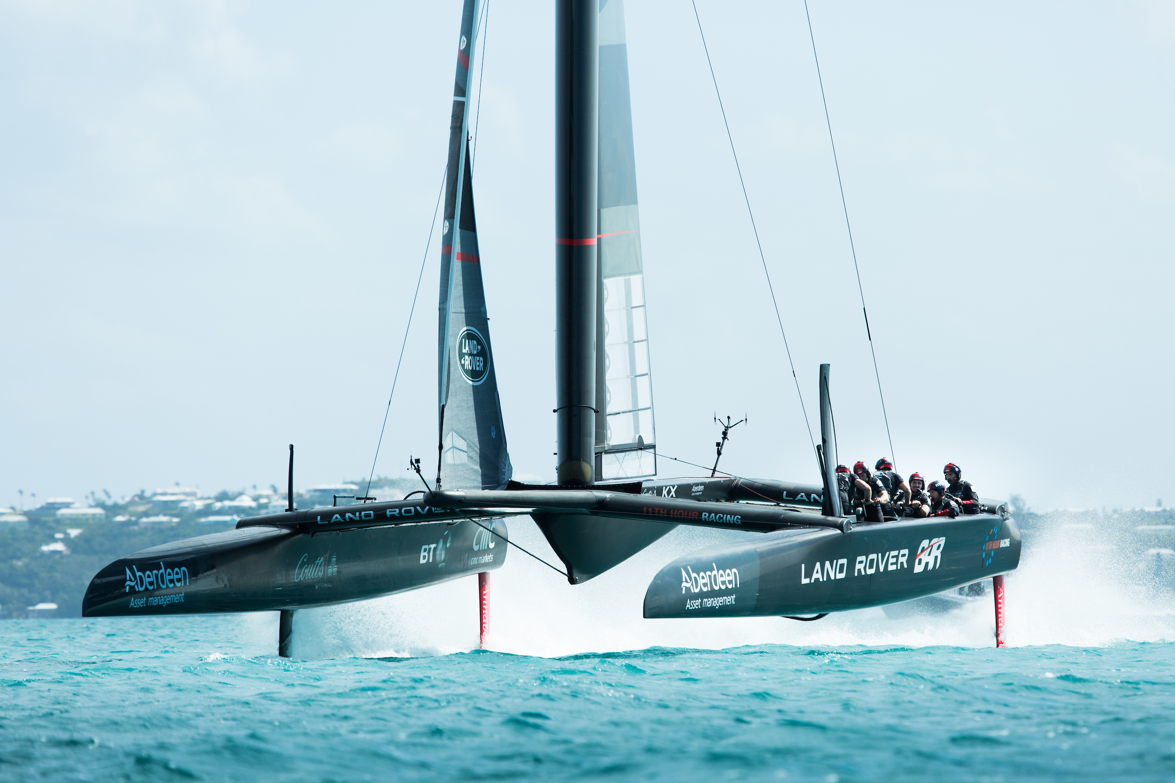

America's Cup Class (ACC) racing yachts use an innovative type of sail called a sail-wing. This operates like the wing of an aeroplane and produces ‘lift' which drives the vessel forwards. The wing used by the Land Rover BAR race-yacht ‘Rita' (code-name: R1) has a sail area of 103 m2 and is 23.5 m high, which is comparable to the main wings of an A320 aircraft. Clearly, there are many difficult engineering challenges involved in designing and building a huge functional wing with numerous moving parts, whilst ensuring sufficient strength and minimal weight. The R1 is a state-of-the-art catamaran that literally flies above the water on a pair of hydrofoils. This type of foiling design has allowed the sport to reach spectacular new speeds.

The R1 at speed in BermudaWhy put position encoders on the control surfaces?
