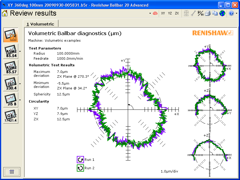

The new design also allows testing in 3 orthogonal planes through a single reference point. A single, simple hardware set up means quicker testing and the ability to produce a representative volumetric measurement of positioning accuracy. The QC20-W ballbar retains the principle of a simple CNC circular program, and powerful software. Together, these can quickly diagnose and quantify machine positioning errors including, servo mismatch, stick-slip errors, backlash, repeatability, scale mismatch and machine geometry as well as giving an overall circularity error value.

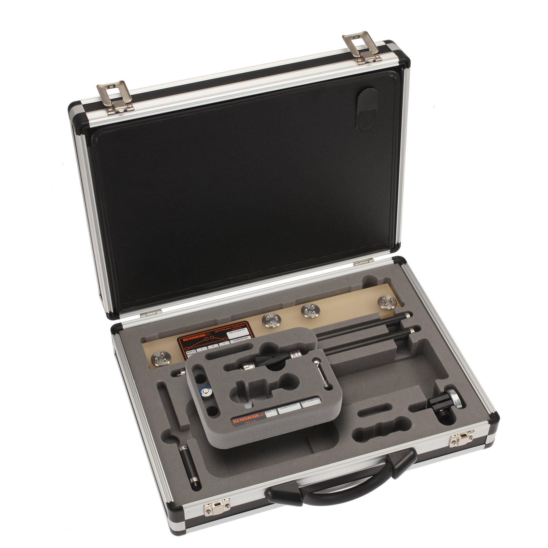

The Ballbar 20 system software has been enhanced to give even greater flexibility for testing and reporting. The QC20-W kit is supplied in a redesigned, robust system case, which includes spaces for the most popular accessories.
