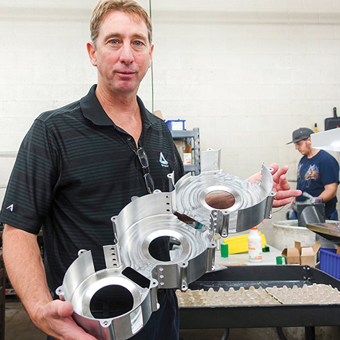

  • R&D Manco - a part such as this would have begun as a casting
    In the past, a part such as this would have begun as a casting. In every case in which R&D Manco can successfully covert the job to being machined out of solid instead, it can save the customer both cost and lead time. But doing this requires the shop to step up to a more significant role.

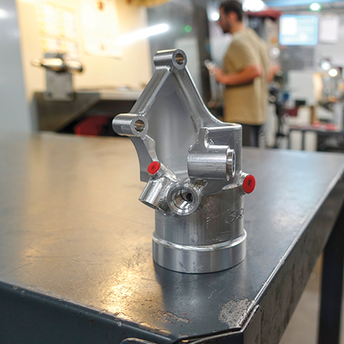

  • R&D Manco - some parts need to be cast
    The enemy? No. Some parts need to be cast. This part is an example: The internal geometry would be impractical to achieve in a hogout. Though the shop can serve customers by converting castings to hogouts, there will continue to be many cases in which a casting is the best choice.
