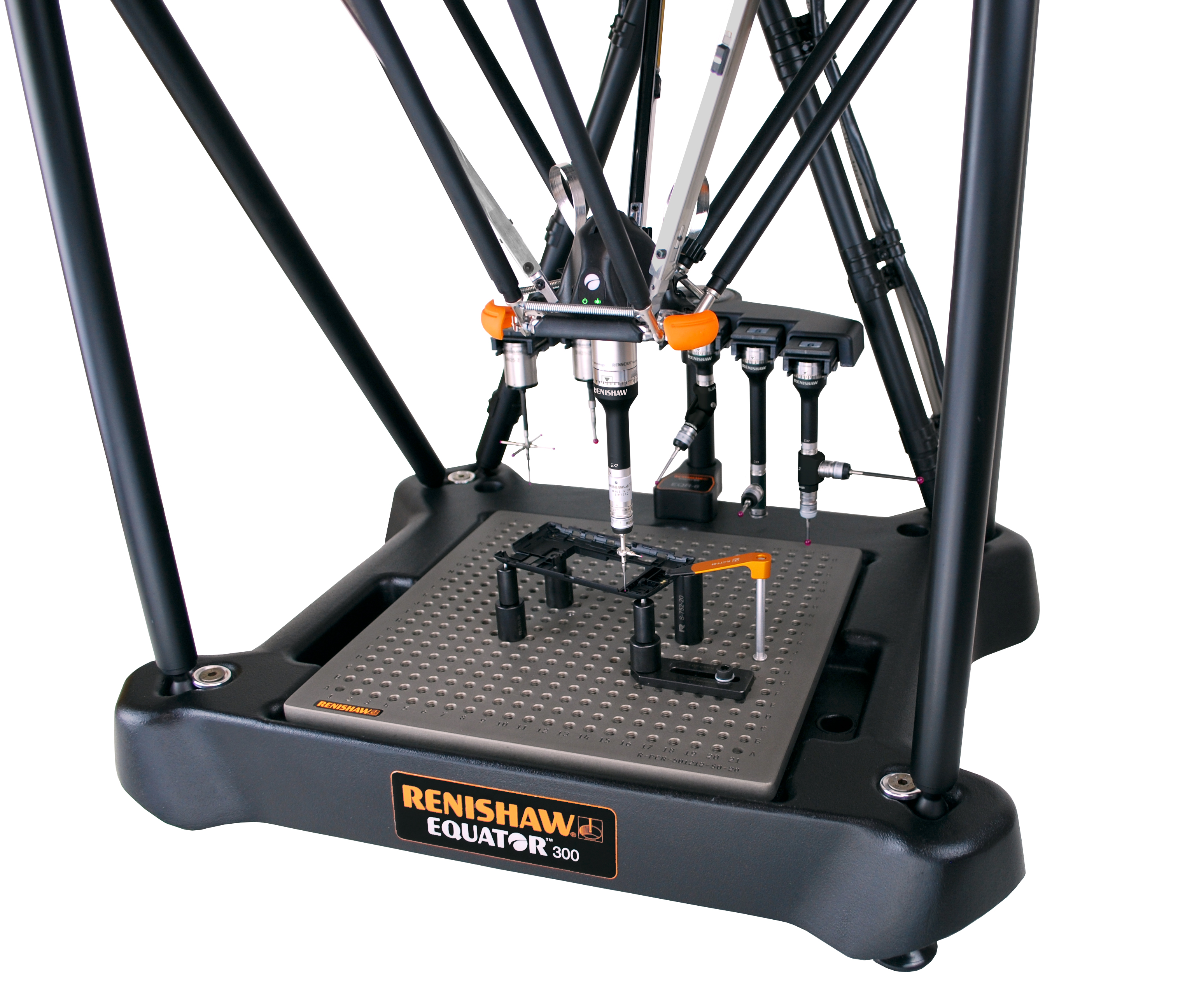

The ultra-fast TP20 touch trigger probe can now be combined on Equator with the high speed scanning of the SP25 scanning probe.
TP20 can be used for fast capture of discrete point data, with the stiff lightweight structure of Equator allowing very short cycle times and high repeatability on simple touch point measurements. The touch trigger kit includes robust industry-standard TP20 modules and a new range of extension bars and joints.
The system can also automatically switch to the SP25 scanning module using the integrated changing rack to provide any combination of measurement routines. SP25 allows continuous scanning of features at scan speeds of up to 200 mm/s, to gather high volumes of data when, for example, information on the form of features is required.
Equator with TP20 is an ideal alternative for in-line gauging tasks which might have used custom hard gauging systems with single-point air gauges or LVDTs. The advantage of flexible gauging with Equator is that part geometry can be computed simply by taking additional data points, rather than the need for a complex custom gauge.

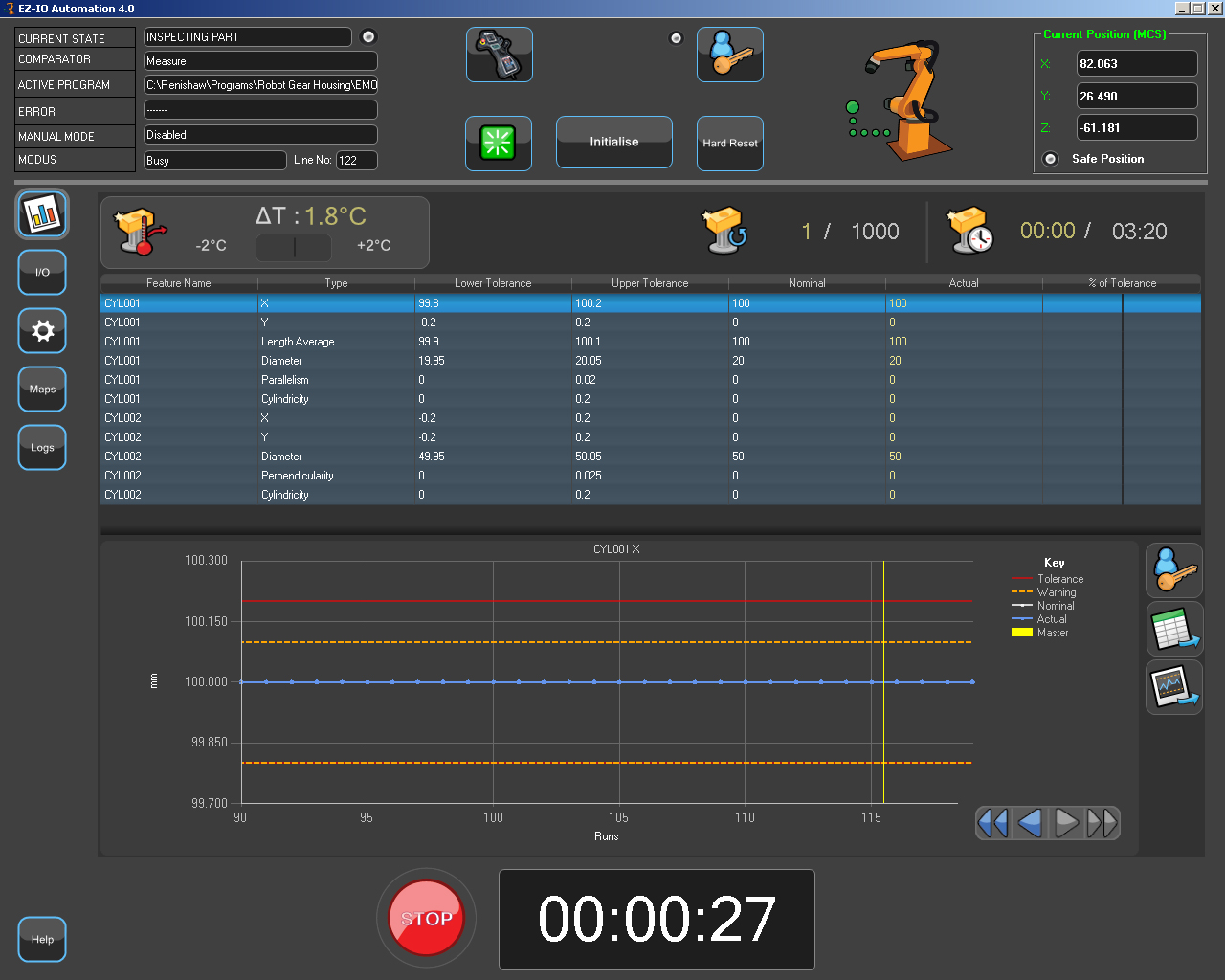

EZ-IO automation software with Process Monitor
EZ-IO software makes it very easy for integrators setting up automated manufacturing cells to configure communications between Equator systems and the cell controller. This allows intelligent functions such as automatic re-mastering: using a robot or shuttle system to load the master part when Equator detects that the shop floor temperature has changed.
The Process Monitor display is now built into EZ-IO. Process Monitor provides a chart showing the history of feature measurements, and an easy graphical view of proportion of tolerance for each feature. It also enables management of the mastering process according to temperature, time or number of parts measured. Being able to view the inspection data history of a part is an invaluable function for controlling manufacturing processes.
