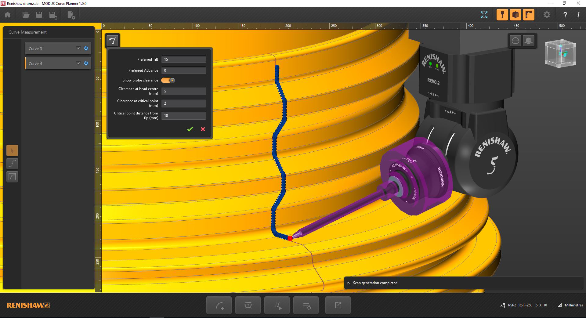

MODUS 1.13 software offers multiple enhancements in flexibility and usability for REVO sensors. Users can benefit from powerful new features within its specialist programming (MODUS Planning Suite) and reporting (MODUS CHART) tools.

Pacote MODUS Planning - Desenho de curva [gen]
[626kB]
