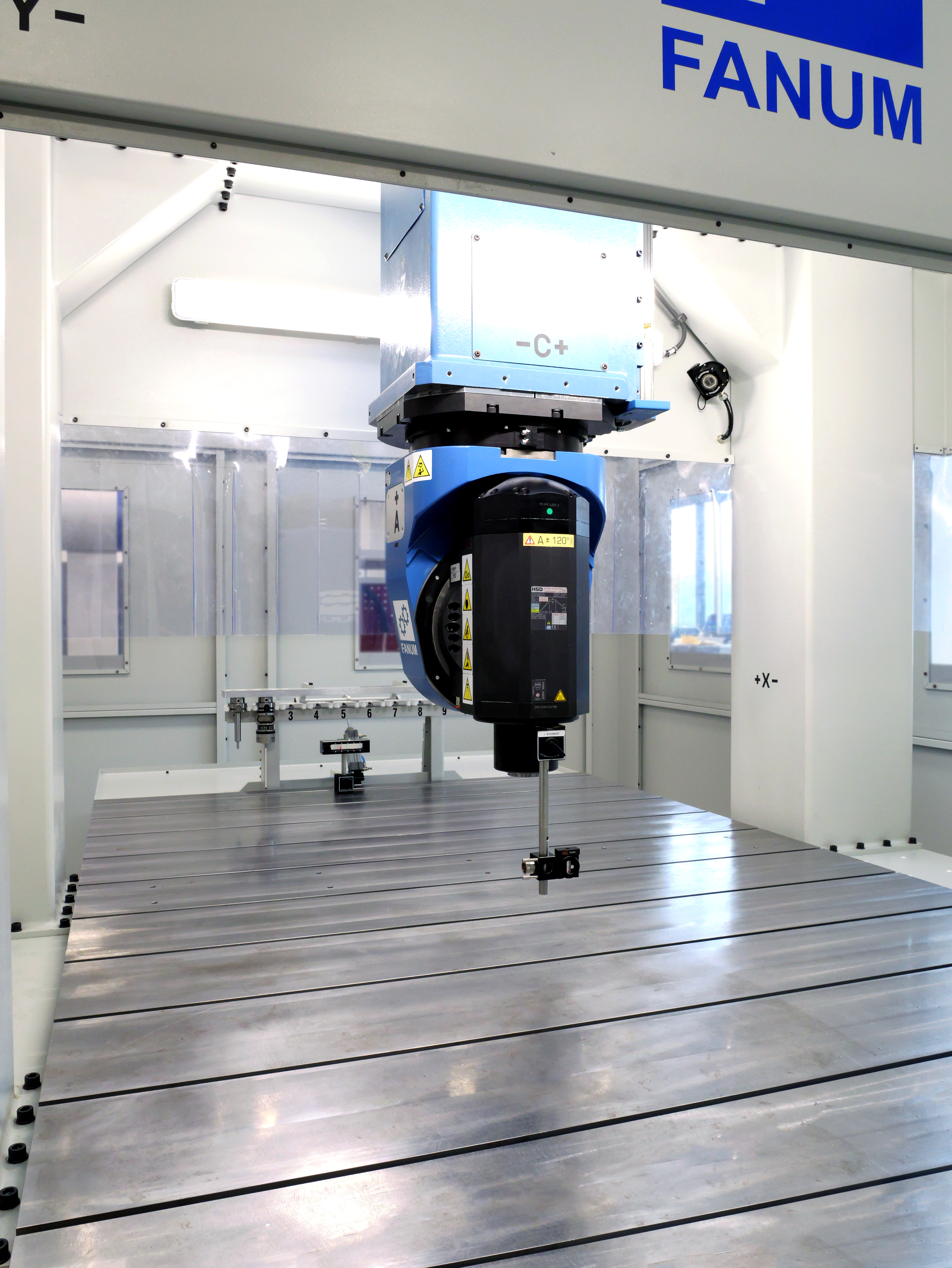

XM-60 data stitch measurement on a multi-axis machine
XM-60 alignment on a multi-axis machine
Data stitch measurement on a 5-axis CNC machine
Setting up an XL-80 data stitch measurement on a 5-axis CNC machine
