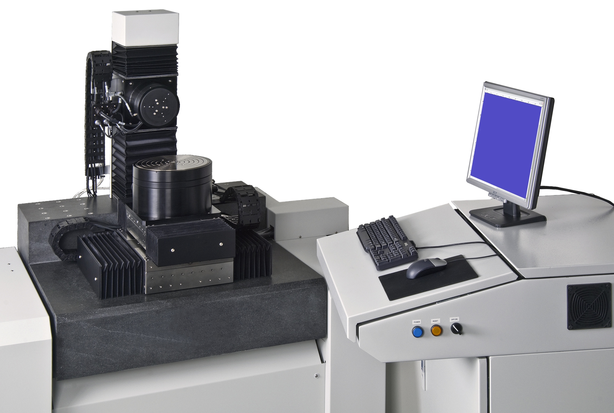

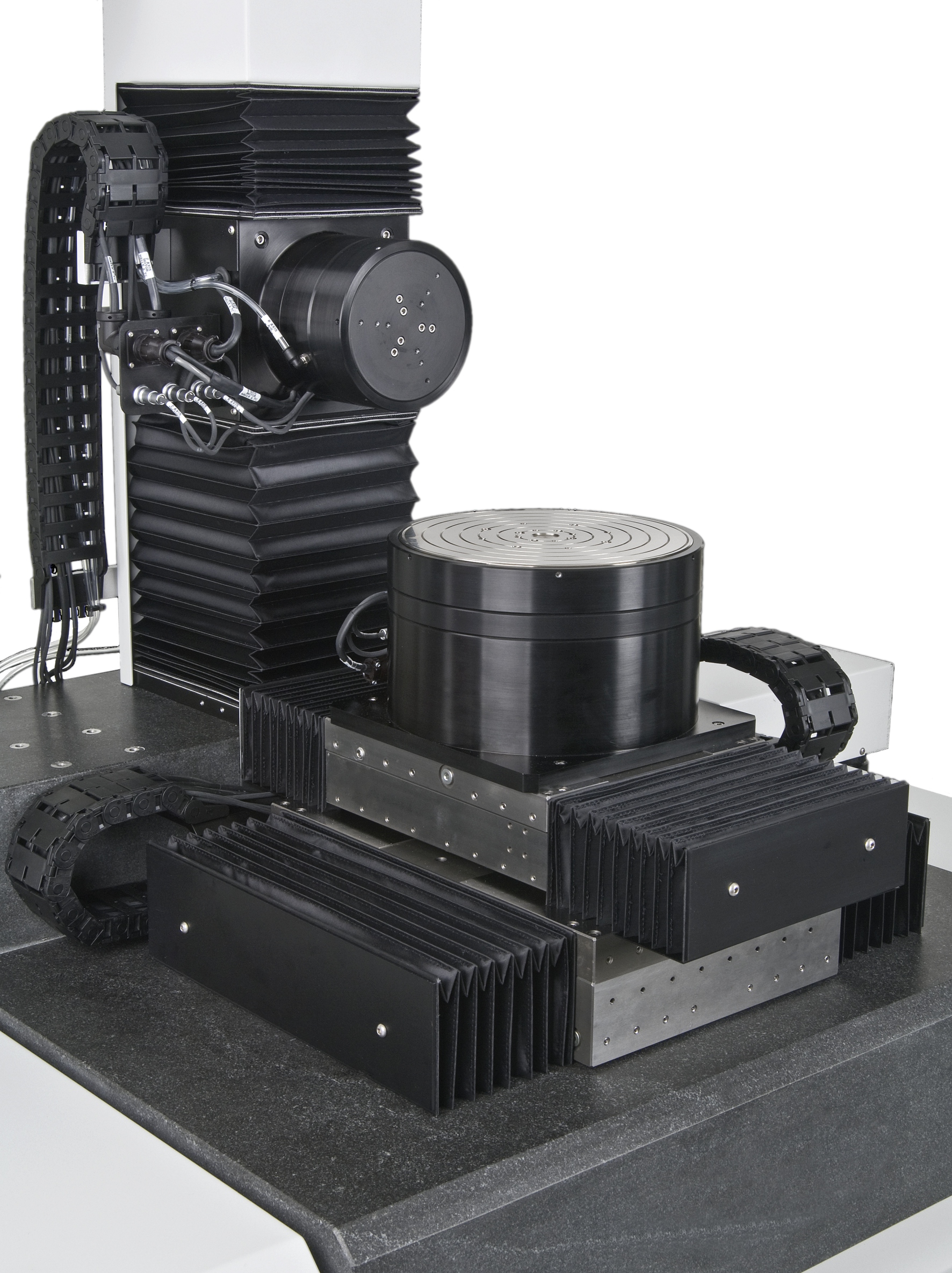

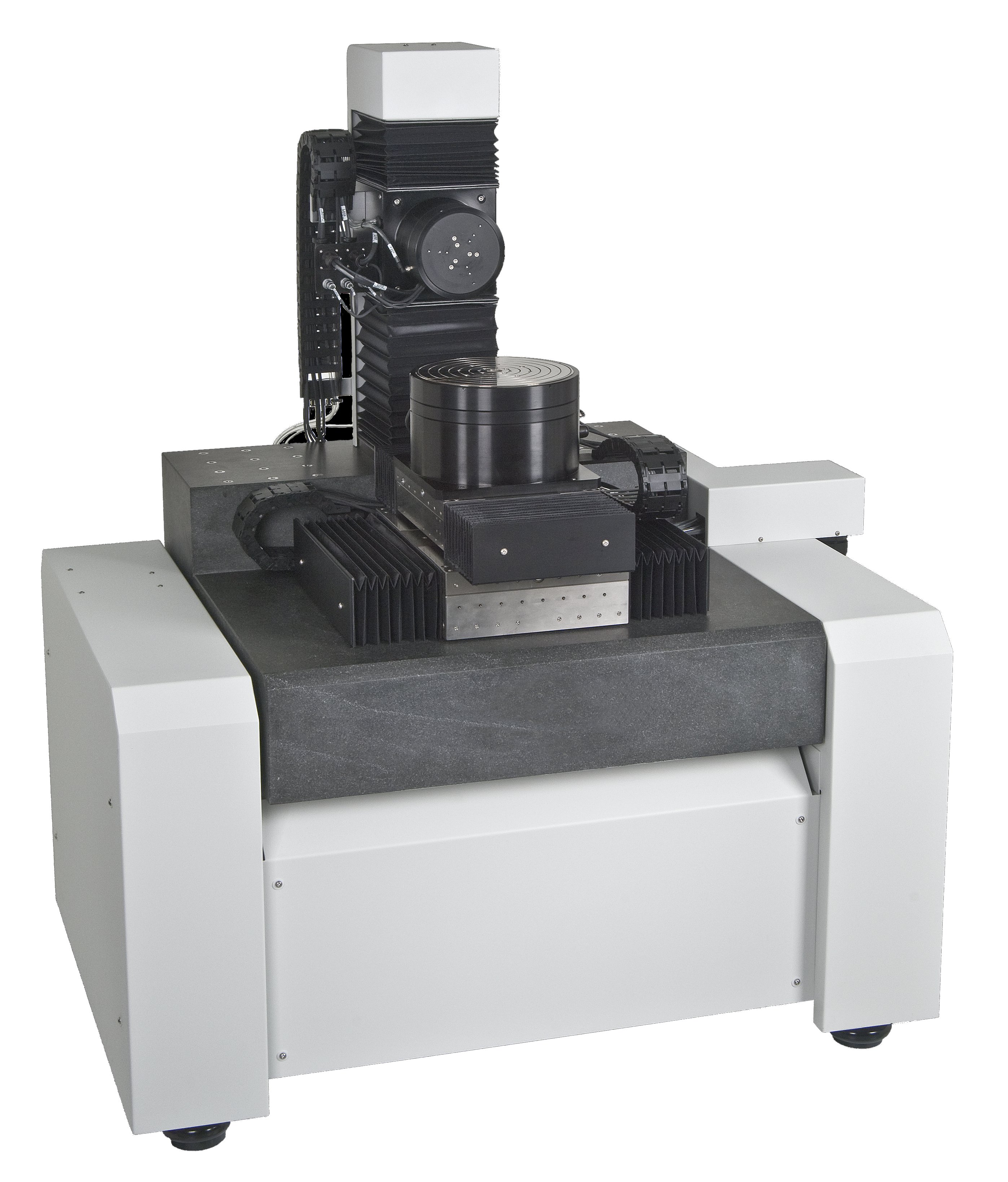

In operation, a lens is placed on a high-precision B-axis rotary table for measurement by a non-contact confocal imaging probe mounted horizontally on a rotary C-axis air bearing.  Confocal imaging performs microtopographic mapping of the lens geometry and surface.
The system requires that the confocal probe be positioned normal (perpendicular) to each surface point to be measured.  The platform created by ABTech accomplishes the exacting repositioning by coordinated motion in up to five axes. The next-generation CNC optics inspection systems require position resolution of 5 nm for the three linear axes. Resolution for rotary motion is 0.009 arcsec/count for the C-axis and 0.018 arcsec/count for the B-axis. Fully programmable 32-bit Windows-based measuring software drives the non-contact probe to automatically collect microtopographic data.

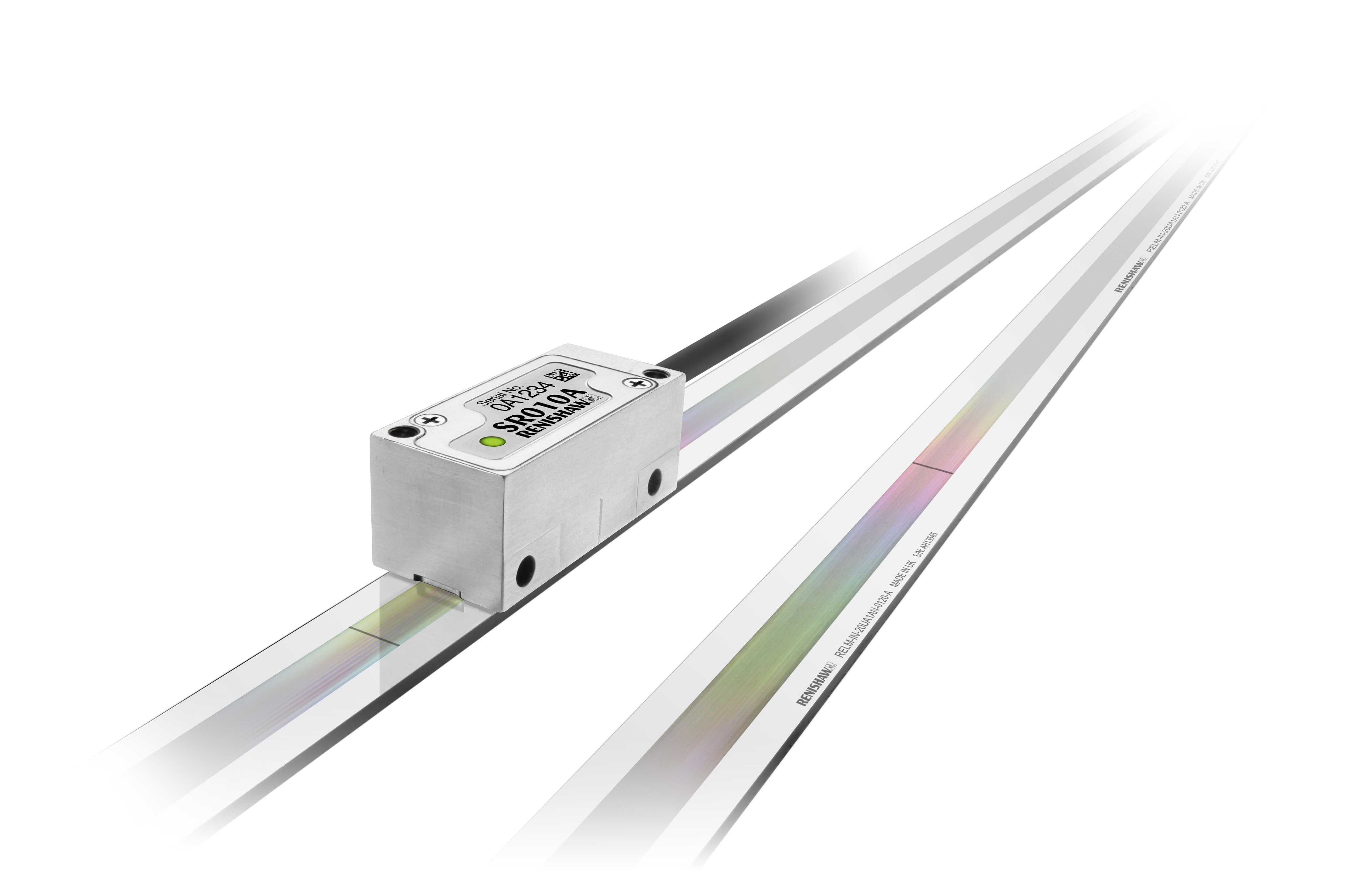

Goggin recommended an advanced SiGNUM™ rotary and linear system – the high performance dual-readhead DSi rotary encoder system and the RELM high accuracy linear encoder system. These SiGNUM™ encoders provide accuracy better than ±1 µm, ±30 nm cyclic error, and resolution down to 5 nm/0.005 arcsec. Dynamic signal control enables the 20 µm scale position encoders to offer "fine pitch" performance without the fragility and optical cleanliness constraints of glass encoders and enable outstanding dependability in manufacturing environments, high tolerance of shock, vibration and temperature (to 85 °C).
SiGNUM™ RELM high accuracy linear encoder systemEspecially important to ABTech, the RELM linear encoder system features a scale of stabilized Invar. This nickel/iron alloy offers exceptionally low coefficient of expansion (≈0.6 µm/m/°C, 0 °C to 30 °C). "This being a metrology system, we were most concerned about thermal stability", said Abbott. "Most of the machine is fabricated from stainless steel, granite and ceramic to minimize thermal growth. The Invar scales were a perfect fit for this application".
Accuracy, price, ease of use and physical size were key factors for ABTech in selecting position encoder. "The encoder needs to be small", Abbott emphasized. The 20 µm Invar scale met those needs with a smaller cross section than glass scales of just 0.059” x 0.591”, along with easier handling and installation without risk of breakage.
The scale incorporates Renishaw's IN-TRAC™ optical reference mark, providing a bi-directionally repeatable datum point across the entire speed and temperature range without increasing overall system width. Dual optical limits are also available as position markers to indicate end of travel.

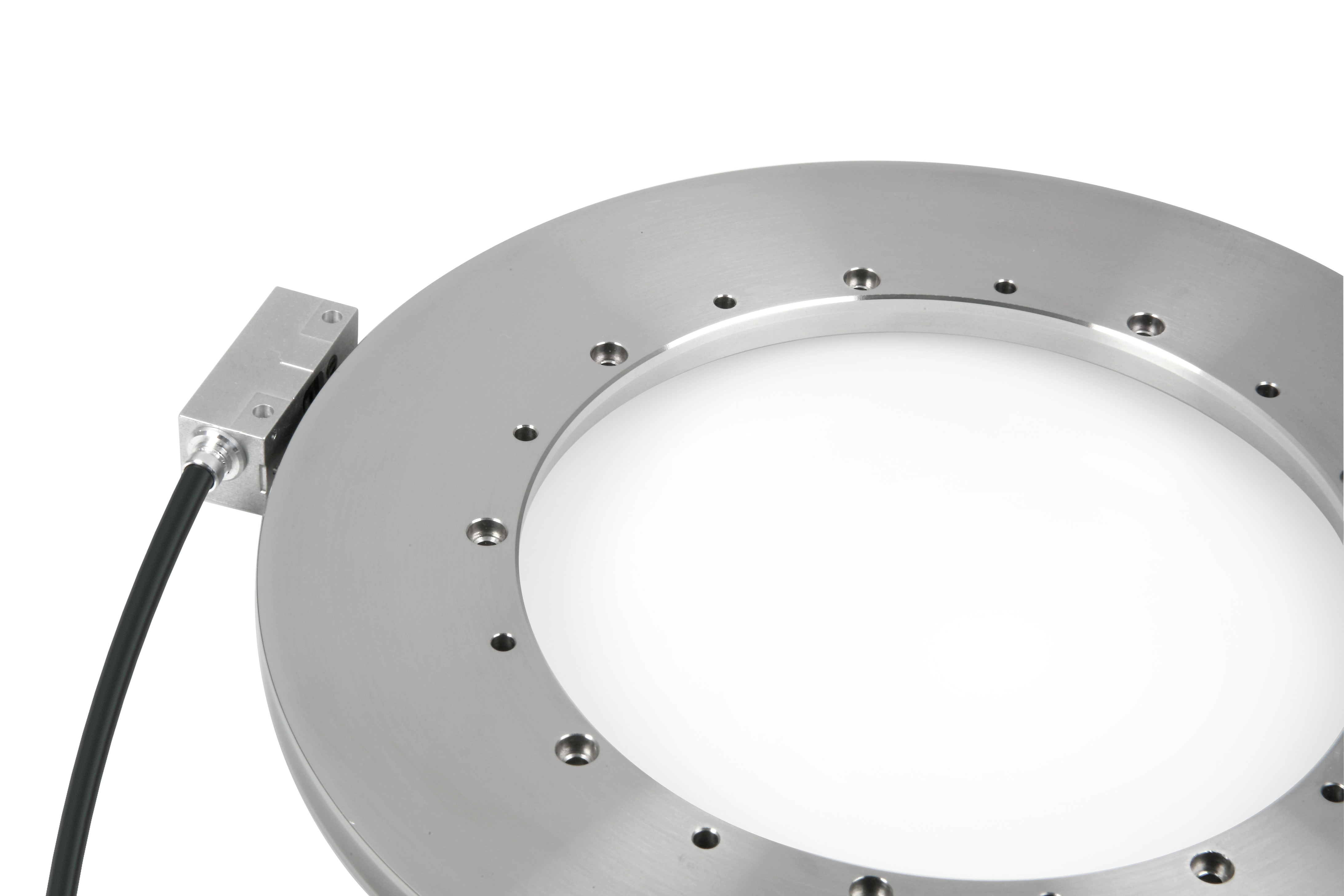

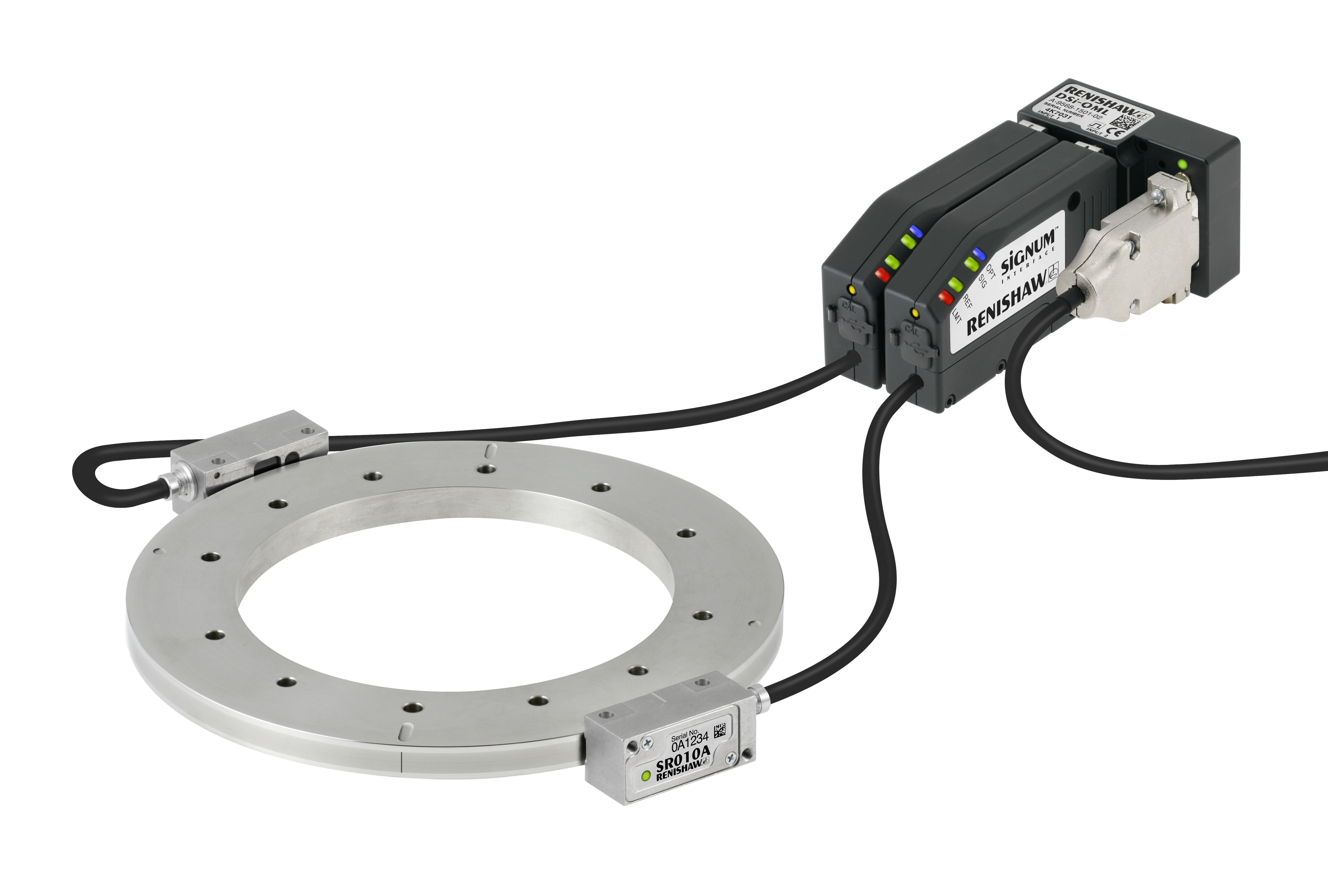

For rotary position accuracy, ABTech selected the DSi (Dual SiGNUM™ interface) and REXM rotary encoder system, Renishaw’s highest accuracy SiGNUM™ rotary encoders. Capable of total installed accuracy of better than ±1 arc second, the DSi configuration combines two error-correcting SiGNUM™ SR readheads with an ultra-high accuracy REXM ring/scale and provides a customer-selectable propoZ™ reference (index) position which is completely unaffected by bearing wander or power cycling.
"Located in 180° opposition, the two readheads cancel out odd error harmonics, including eccentricity, and compensate for the effect of bearing wander", explained Goggin. "By combining the incremental signals from the two SiGNUM™ readheads and using Renishaw's patented reference mark processing, the DSi appears to the controller as a single, very high accuracy encoder".
DSi and REXM ultra high accuracy encoder systemThe other element in the accuracy equation, the REXM ring, features a thick cross-section to minimize all installation errors except eccentricity, which is corrected by the DSi. Once the interface has eliminated the effects of eccentricity, the only significant errors remaining are minor even-harmonic distortions in installation, graduation and cyclic error (sub-divisional error – SDE), which are exceedingly small, as low as ±0.5 arc second and ±0.03 arc second respectively. "When the REXM ring is used with the DSi, it is possible to realize a total installed accuracy of better than ±1 arc second", he said. "In fact, DSi/REXM rotary encoders have achieved total installed accuracies below ±0.25 arc seconds, depending on ring size".
The one-piece REXM stainless steel ring is available with diameters from 2.047” to 16.417” and has scale graduations marked directly onto the outer periphery. The integral ring/scale locks directly to the rotor, eliminating reversal errors, coupling losses, oscillation, shaft torsion and other hysteresis errors that plague enclosed encoders.
To create the desired propoZ™ reference position, the user drives the axis to the chosen angle and simply presses a button. In this way, propoZ™ technology makes aligning the reference position to the T-slots on a machine tool for example, a far quicker, easier and more accurate process. The selected angle is then stored in the DSi’s memory, where its output position is automatically compensated for error by powerful algorithms, ensuring perfect angular repeatability, even if the center of rotation of the axis moves while the DSi is switched off.
The linear and rotary encoders share SiGNUM™ encoder design features, including rugged IP64 sealed readheads, dynamic signal processing for excellent reliability, and ultra-low cyclic error (<±30 nm).

Renishaw’s compact readhead design met ABTech's tight size constraints.  While the five-axis platform is substantial at 53" wide, 38" deep and 66" tall, the individual axes are packed full of motors, encoders and air bearing surfaces, Abbott stressed. "The small size of the Renishaw package allows us to maximize the size of our air bearing pads, which is critical to achieving high stiffness and accuracy". The linear and rotary encoders share the same miniaturized readheads, just 0.583” x 1.417” x 0.650” (HxLxW), while the RELM scale is just 0.591” wide and the REXM scale only 0.394”.
