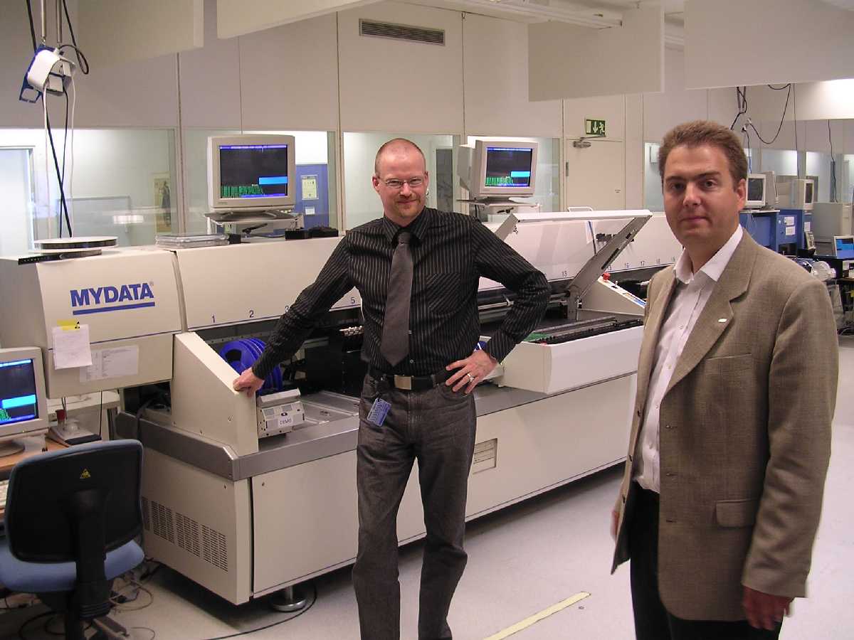

Ollie and Robert from MydataIts new generation of large-board machines has broken new ground, with recently integrated Renishaw linear encoders being key to the performance.

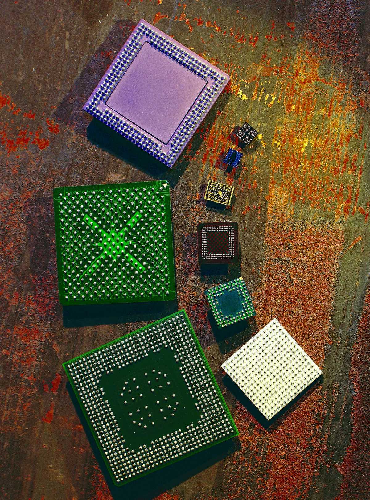

Mydata BGA's varietyThe electronics industry experiences extremely rapid advances in technology, placing constantly increasing demands on production machinery. MYDATA machines must be capable of placing components with a very high level of accuracy, to cope with an ever increasing variety and complexity of components, for example smaller BGAs (Ball Grid Array) and tiny ‘flip-chips’ (where the electrical connections are made directly to the chip’s silicon). These components have the added need for far higher positional and rotational alignment to ensure the extremely high levels of quality, now considered standard.

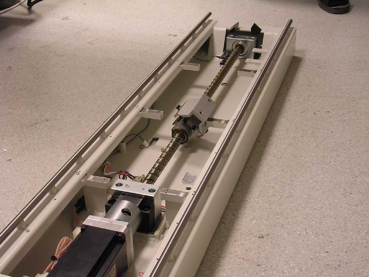

Renishaw encoders have been key to design changes on the Y-axis of certain MYDATA machines where, instead of the ball-screw and rotary encoder drive system, linear motors and linear feedback have now been employed. Olle Tullstedt, MYDATA R&D manager, explains “The linear motor and Renishaw encoder give us a big advantage, particularly when handling large boards with the T5 and T6 board handling conveyors, a capability unique to MYDATA.” While the machine's acceleration and top speed are comparable to the ball-screw/rotary encoder drive, the stiffness is much greater, meaning that the time taken to stabilise position after a move is much shorter and overall speed of operation is greater. The positioning accuracy is also far better, and consistent along the whole Y-axis travel. On the ball-screw system the rotary encoder is remote from the head such that the positioning uncertainty varies along the axis travel. This is not a problem with the machines that handle smaller boards, but has a considerable effect on machines with large-board conveyors.

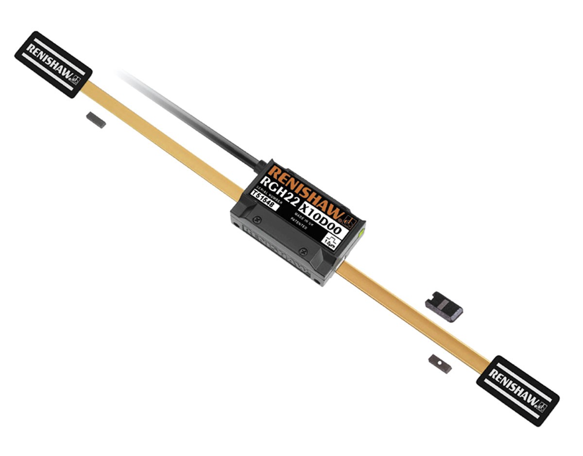

Mydata linear motor encoderMYDATA has found other key advantages in using Renishaw linear encoders, including ease of installation. Robert Pettersson, MYDATA Servo Engineer, comments “We tried several linear encoder systems and found Renishaw readheads very user-friendly. They were much more forgiving when we were aligning them on the axis, saving us time when setting up. Alignment is also extremely easy, probably the biggest factor being the bi-colour LED on the readhead, which gives us a very clear visual alignment indicator at all times.”
“The end clamps Renishaw supplies are vital to ensure the scale expansion is linear and tracks the overall expansion of the system. Linear motors have a localised heating effect – the Renishaw scale distributes the expansion evenly.” Mr Pettersson has no issues whatsoever with accuracy and resolution, and has had no experience of any inconsistencies or quality concerns.

Mydata ball screw and rotary encoderMYDATA machines are extremely flexible and versatile in their operation. While other manufacturers’ high-volume electronic production machines can achieve raw speeds of up to 60,000 components per hour, this can be largely irrelevant if a process takes hours to change over. After all, how fast is a machine that is standing still? MYDATA machines are ideal for short batch jobs, allowing many customers to free up their ‘chip-shooters’ for the long batch production.

RGH22 systemIn an industry showing tentative signs of improvement, MYDATA is continuing to innovate and develop its systems to cope with all the latest components and variety of tasks. Renishaw linear encoder systems have already contributed to significant advances and are likely to contribute further in the future.
