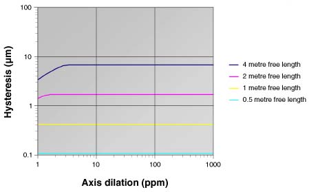

Typical FASTRACK™ linear encoder system hysteresis graphFASTRACK’s unique design is capable of retaining scale securely at very high acceleration loads, yet minimises drag between the two components to allow free expansion of the scale at its defined expansion coefficient. Hysteresis is therefore also kept to a minimum… less than 1 µm on a centre-clamped 2 metre axis on an aluminium substrate, over the entire operating temperature range!
Another unique metrology advantage of FASTRACK comes from the clamping method that locks the scale to the substrate at a single point without distorting the scale; a significant improvement over the clamps used on traditional carrier-type encoders. This arrangement enables the system builder to clamp the scale at the ideal point for the machine without compromising accuracy in that region; a feature that’s particularly important for centre-clamping of a high accuracy axis.
This graph is used to determine the hysteresis of a FASTRACK installation on any substrate and for any temperature range. The x axis represents “relative dilation”, ie, the difference between substrate expansion and scale expansion. The y axis shows the hysteresis that occurs due to drag of the substrate expansion on the scale. To use this graph, first calculate the relative dilation using the formula:
Relative dilation = (substrate expansion coefficient – scale expansion coefficient) x temperature change
Now move along the y axis until you reach the line that most closely matches the “free length” of the scale, ie, the length between the end of the scale and the position of the clamp.
Example: a 2 metre axis clamped in the centre, mounted on a granite substrate, with a temperature range of 20°C.
Relative dilation = (8 µm/m/°C – 10.6 µm/m/°C) x 20 = 52 µm/m
At a relative dilation of 52 µm/m, the 1 metre free length line is at 0.426 µm. Therefore, for the conditions described, the hysteresis will be 0.426 µm.
