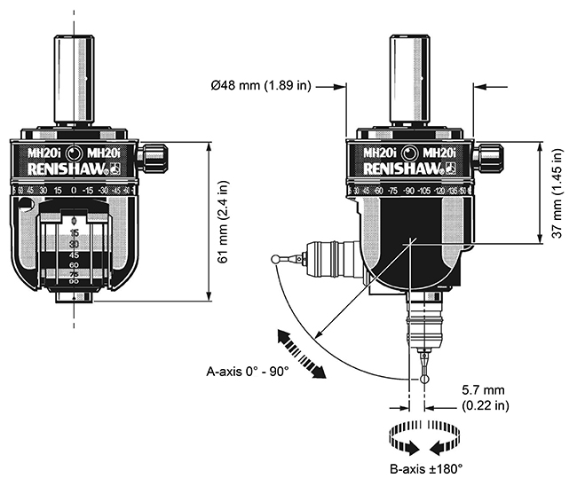

Dimensions
MH20i dimensions

A-axis indexing
0° to 90° in 15° repeatable steps = 7 positions
B-axis indexing
±180° to 90° in 15° repeatable steps = 24 positions
