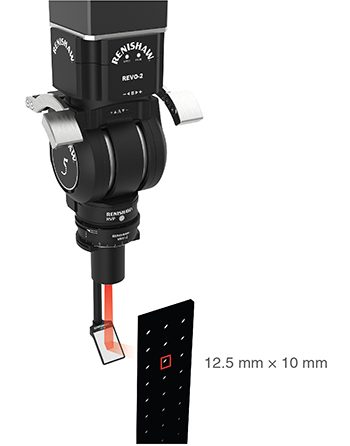

Field of view
12.5 mm × 10 mm

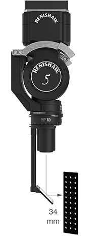

Stand-off from mirror
34 mm (from mirror centre)

VM11-2 with ACM stand-off
RVP stand-off - ACM
Stand-off is described as the distance required between the bottom of the vision module and the part feature to ensure optimum metrology performance.
Vision modules have different stand-off distances to allow the inspection of a variety of parts. The stand-off distance for the VM11-2 module with ACM is 34 mm.

The field of view for each vision module determines the size of feature than can be inspected using a single exposure when the RVP system is at the correct stand-off distance.
The VM11-2 field of view is 12.5 mm × 10 mm; any feature that requires inspection must be within these dimensions to be captured with a single exposure.
