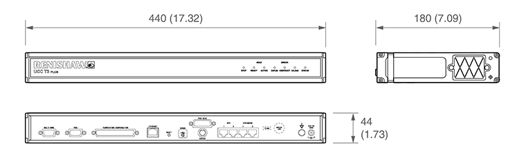

Dimensions
Width | Height | Depth |
440 mm (19 in enclosure) | 44 mm (1U) | 180 mm |
