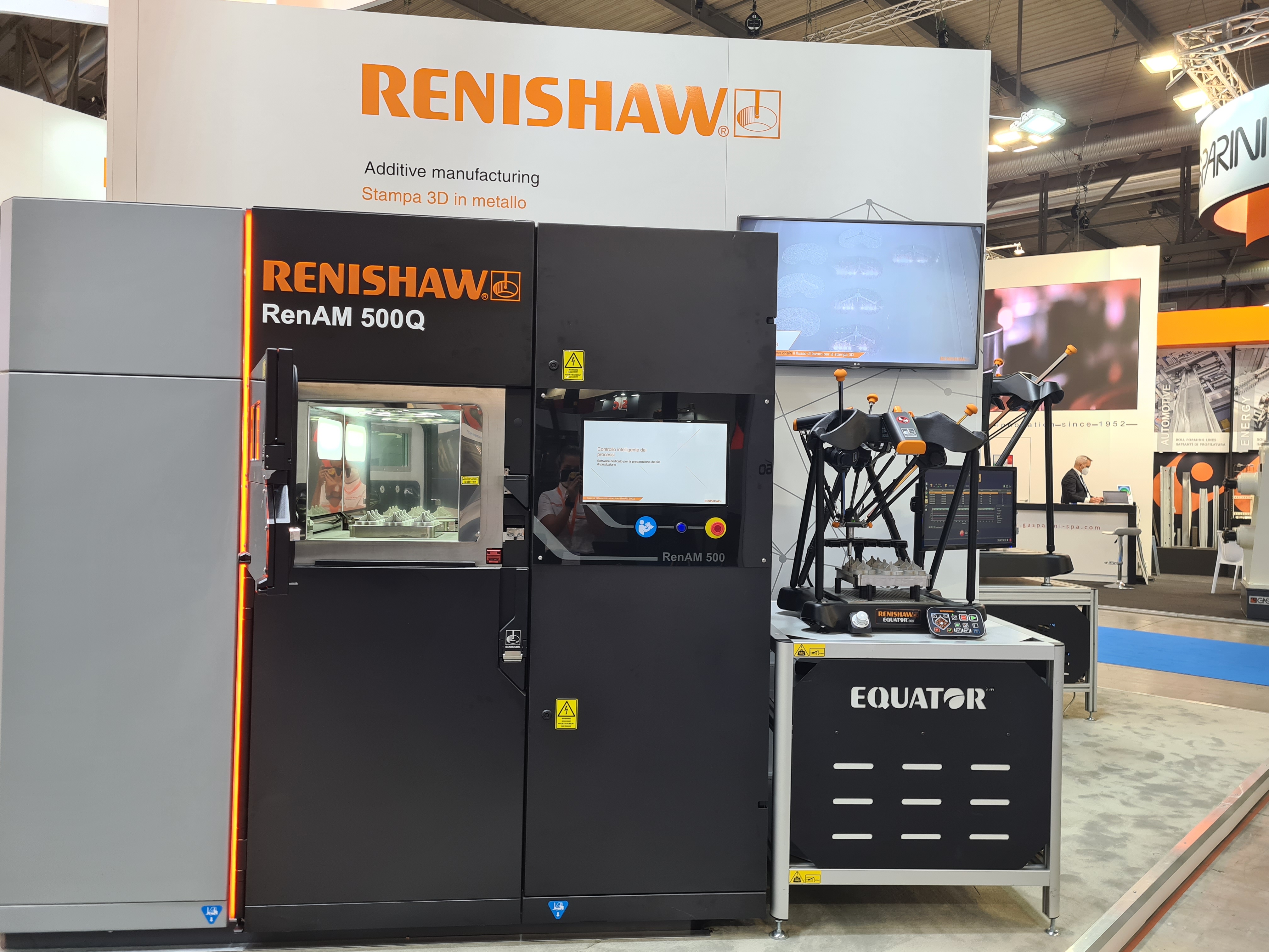

 RenAM 500Q and Equator Gauging System displaying the end-to-end process at EMO Milano 2021 [gen]
[2.3MB] RenAM 500Q and Equator Gauging System displaying the end-to-end process at EMO Milano 2021 [gen]
[2.3MB]
