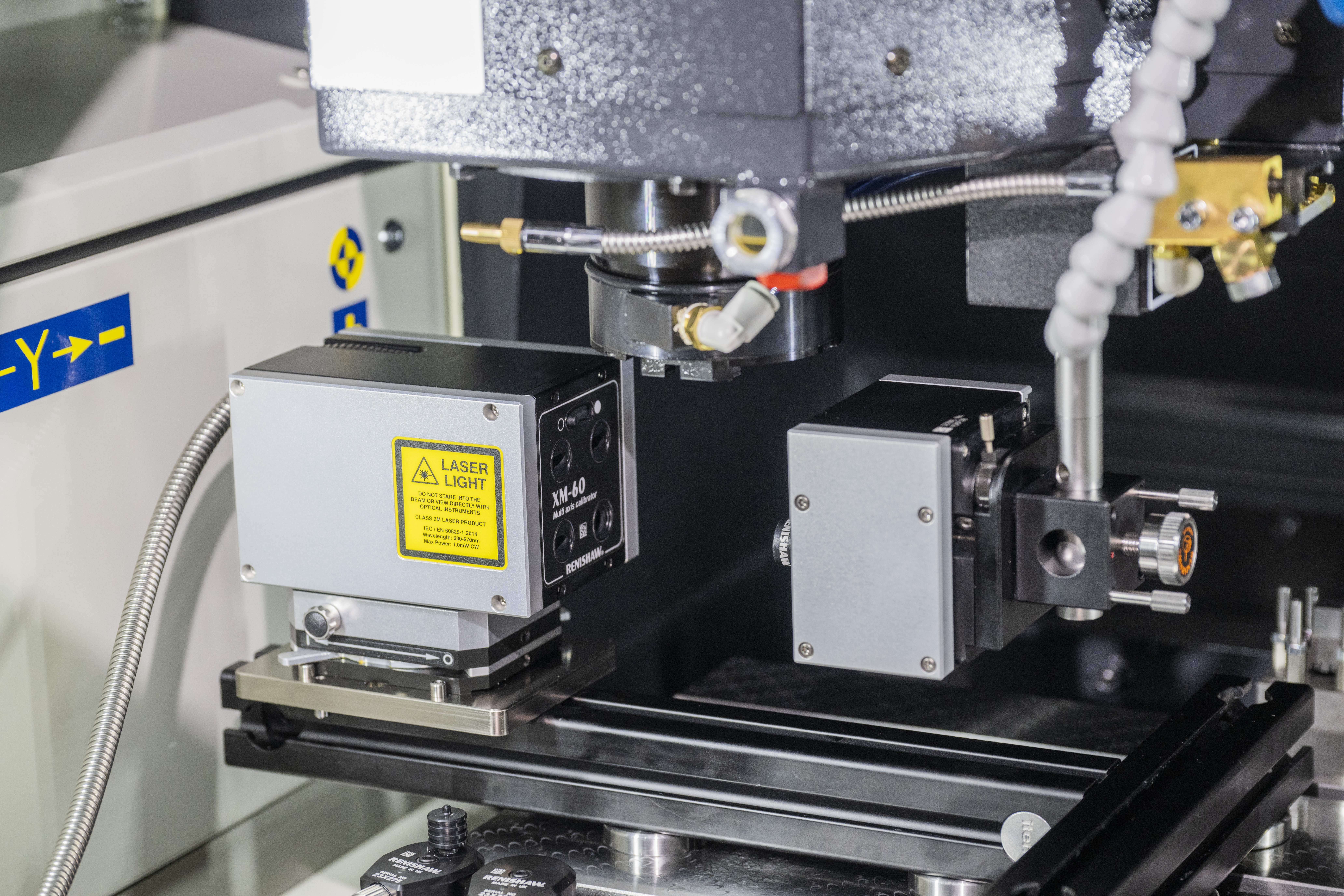

In CMAT's factories, the XM-60 multi-axis calibrator is used to evaluate and maintain product lines' machine performance. Due to rigorous requirements on the machining precision of probe cards, understanding all machine errors is vital to CMAT.
Their inspections cover dynamic straightness and error source analysis for machine axes, as well as volumetric accuracy measurement and compensation.
CMAT now uses the XM-60 multi-axis calibrator to conduct monthly inspections on four machines within its facility, including 5-axis machine tools, generating reports to evaluate machine conditions for calibration purposes.
Before using the XM-60 multi-axis calibrator, CMAT relied on equipment suppliers or traditional tools, such as granite squares and dial gauges, for measuring and maintaining machinery. However, such approaches were inefficient and lacked precision reliability. Suppliers typically use conventional laser interferometers, which only measure the linear positional error of a single axis. They cannot meet CMAT's requirements for measuring with multiple degrees of freedom. Additionally, traditional tools require complex set-ups, which are time-consuming and problematic.
In contrast, the XM-60 multi-axis calibrator offers easy set-up and can measure errors in six degrees of freedom along an axis from a single set-up. It also measures multiple parameters at specific locations and evaluates positioning accuracy at any given location. Renishaw's intuitive CARTO software allows users to learn about a machine's errors quickly. CMAT identified that the XM-60 multi-axis calibrator has significantly increased their overall productivity threefold, with a single operator swiftly and effortlessly measuring errors in 21 degrees of freedom (when used in combination with a QC20 ballbar).

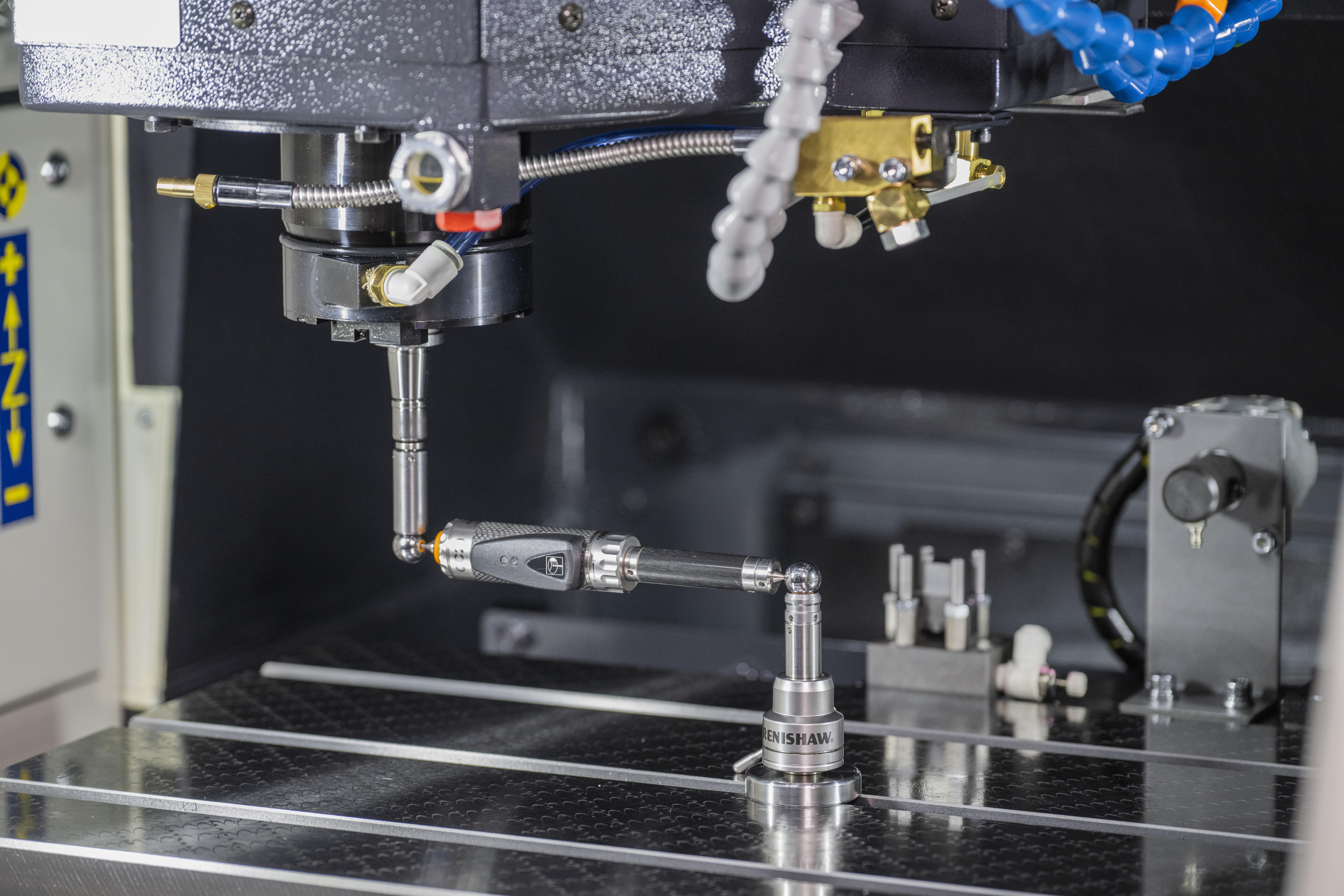

Fast preliminary inspection by QC20 ballbar
Renishaw's QC20 ballbar also plays a crucial role in maintaining the production equipment at CMAT's factory. By regularly performing fast preliminary inspections using the QC20 ballbar, CMAT can gain early insights into the condition of each machine. This enables efficient allocation of limited production resources, the assessment of productivity to meet customer demands, and the accurate forecasting of delivery times.
One notable advantage of the QC20 ballbar is its ability to complete inspections in just 10 minutes, whilst identifying potential machine issues. For a more detailed analysis, the XM-60 multi-axis calibrator can then be used for further inspection.
The QC20 ballbar is integral to volumetric compensation. The XM-60 multi-axis calibrator enables simultaneous measurement in six degrees of freedom for each axis, including linear accuracy, pitch, yaw, and roll, as well as horizontal and vertical straightness. When measuring the X, Y, and Z axes separately, a total of 18 errors can be measured.
Additionally, when used with the QC20 ballbar, three more errors can be measured, totalling 21 three-dimensional volumetric errors necessary for volumetric compensation. By using both pieces of equipment in tandem, CMAT has gained a comprehensive understanding of machine errors and is able to conduct appropriate calibration and compensation operations.
The QC20 ballbar offered us numerous benefits. Firstly, it reduces downtime by 15%, significantly shortening the time required for equipment inspection and enhancing productivity. Secondly, the QC20 ballbar decreases the defect rate by 5%. This ensures precise inspection and evaluation of machine performance, thereby improving product quality. Moreover, the QC20 ballbar assists in evaluating machine conditions throughout the production process. This facilitates timely preventive maintenance to ensure smooth equipment operation and maintain productivity. It also swiftly identifies the causes for substandard processing quality, simplifying the tracking and resolution of issues.
