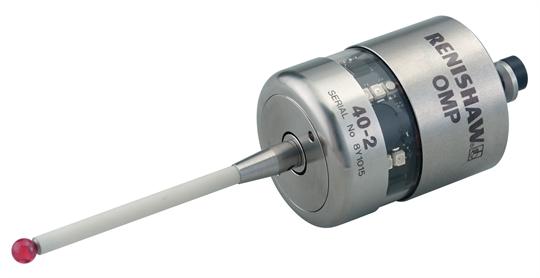

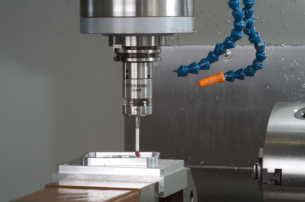

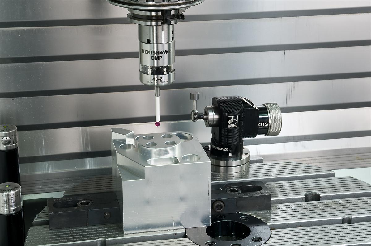

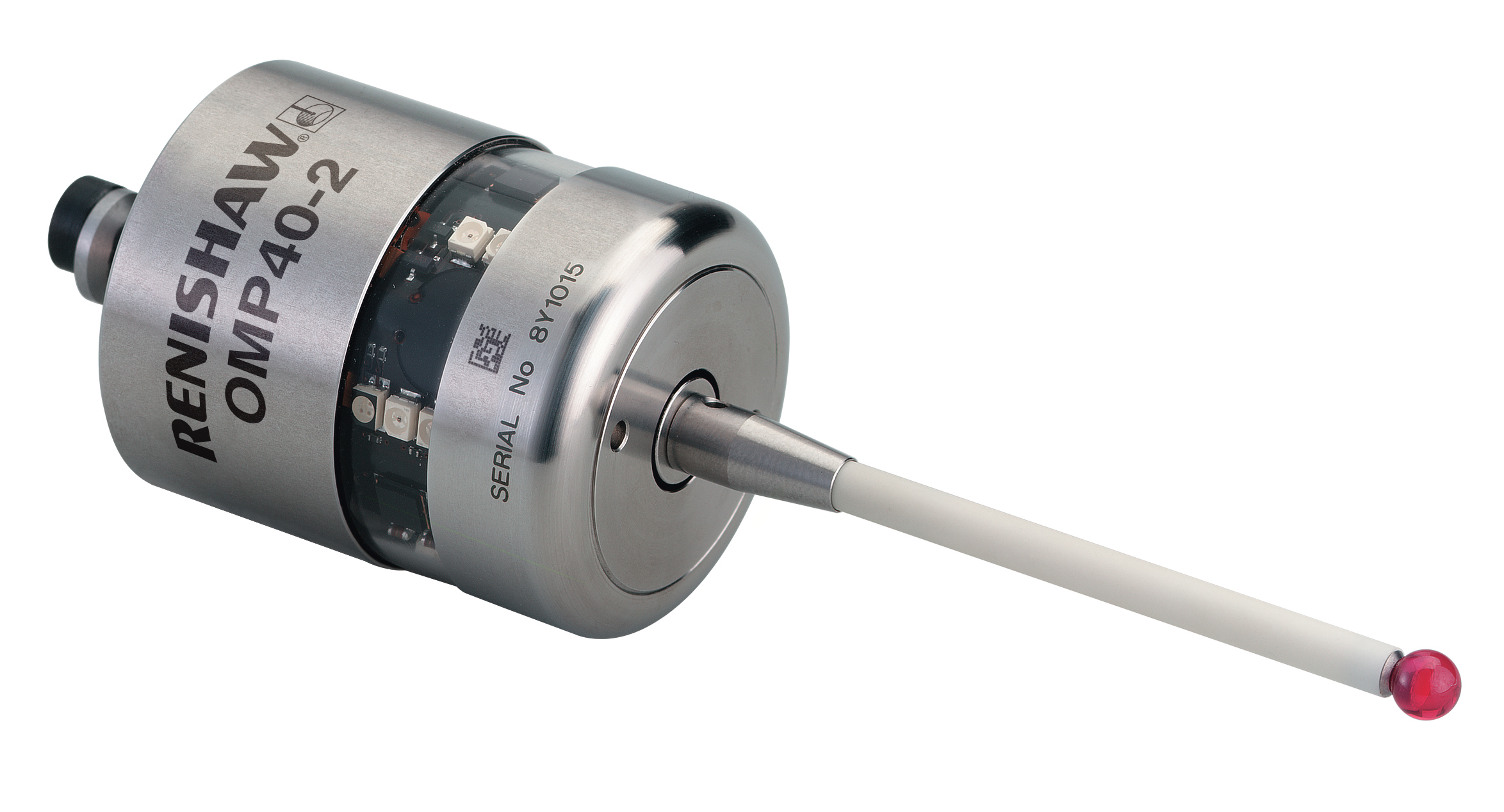

The OMP40-2 is an ultra-compact 3D touch-trigger probe with optical signal transmission. It is used for workpiece set-up inspection on small to medium machining centres, and on the growing number of high-speed machines fitted with small HSK and spindle tapers.
Its compatibility with all Renishaw optical receivers enables users to upgrade existing installations easily.
Features and benefits
- Proven kinematic design.
- Exceptional resistance to light interference with modulated transmission.
- 360° transmission envelope.
- Ultra-compact design.
- 1 μm 2σ repeatability.
Previously it could take 1.5 hours to set a job that took 4.5 hours of machining; that was totally unacceptable. Now we can do the same set-up in 10 minutes, immediately freeing up 1 hour 20 minutes to cut more metal, which we make money on.
