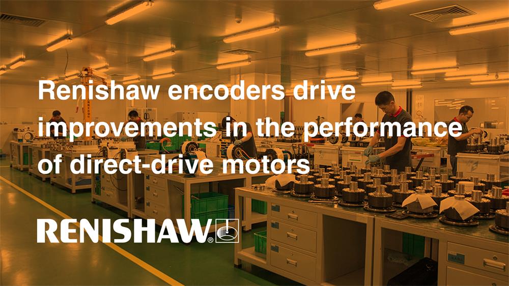

Renishaw encoders drive improvements in the performance of direct-drive motors

Haozhi’s motor assembly line
Haozhi's motor assembly line
