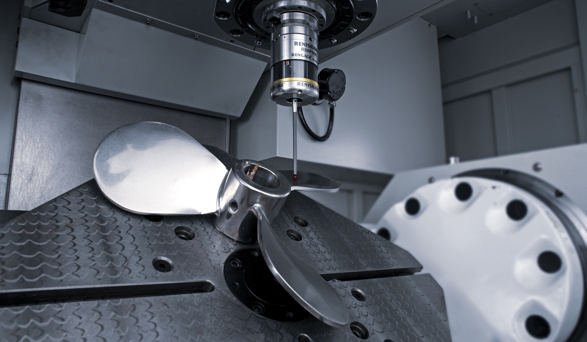

Part of the QE series, the RMP600 is a compact, high-accuracy touch probe with radio signal transmission which offers all the benefits of automated job set-up as well as the ability to measure complex 3D part geometries on all sizes of machining centres, including multi-tasking machines.

The RMP600 strain gauge probe is helping Tridan Engineering accurately machine workpieces for its customers in the automotive industry.

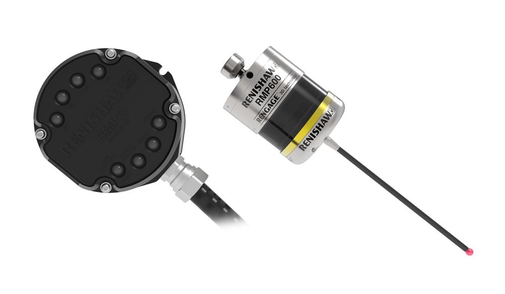

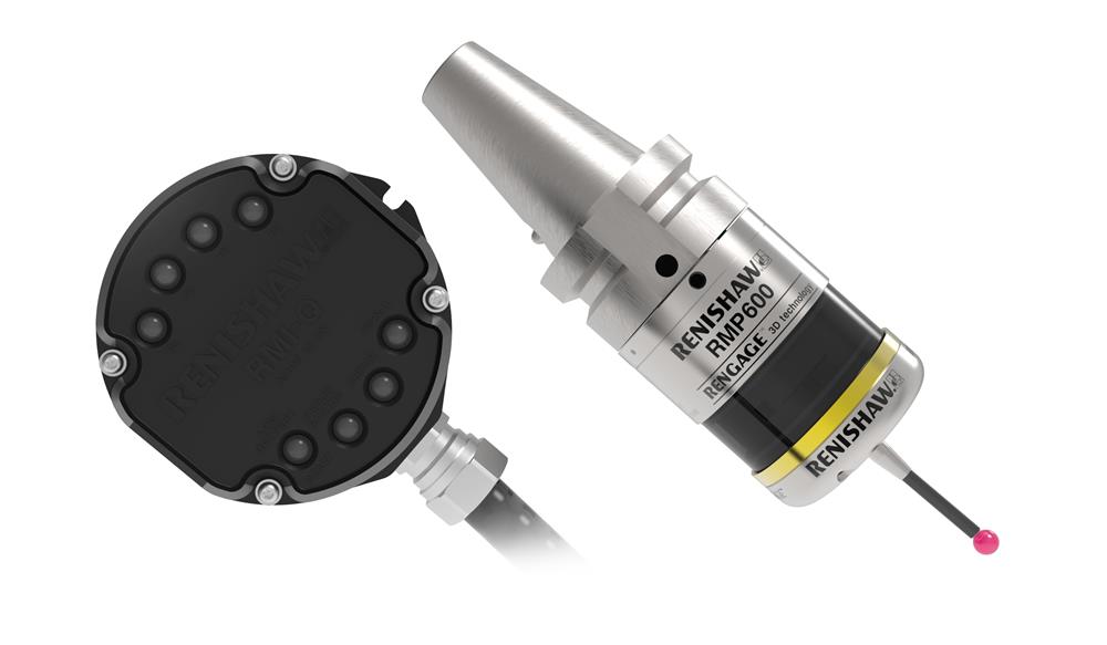

RMP600 inspection probe
A 60 mm diameter touch-trigger inspection probe, equipped with RENGAGE™ technology for high-accuracy measurement and FHSS technology for reliable transmission.
Styli
A range of solid high modulus carbon fibre styli has been developed for use specifically with strain gauge probes. These styli are designed to minimise pre-travel variation and improve the accuracy of the probe.
