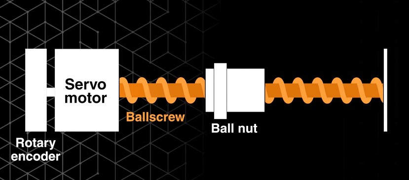

An axis that only uses a rotary encoder and ballscrew to control linear movement is known as a semi-closed servo loop, as seen in Figure 1.

Figure 1: Illustration of the main components used by a semi-closed machine tool servo loop.

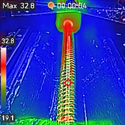

Figure 4: After machining a single component, the heat build-up in the ballscrew is immediately evident. Furthermore, the heat distribution in the ballscrew is uneven.

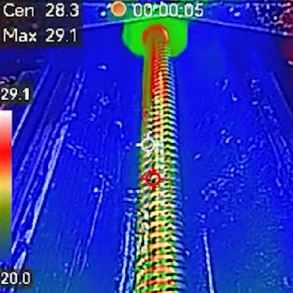

Figure 5: The machine tool was then run to simulate the production of fifty identical parts. As can be seen, the temperature of the ballscrew rose significantly, compared to the initial test, and the heat distribution remained uneven.
Figure 6: Finally, the machine was allowed to cool for a period of 15 minutes. After this time, it was observed that some of the accumulated heat had dissipated, resulting in a noticeable reduction in the overall temperature of the ballscrew.

Under semi-closed loop control, the accuracy changed by approximately 15 µm due to thermal expansion in the ballscrew. However, when the linear encoders were switched on (fully-closed loop), the accuracy of the axis remained almost unchanged from the initial test with the cold machine.
Test 3: after machining 50 parts
For the configuration with linear encoders switched off (semi-closed loop), significant heating in the ballscrew caused an error of approximately 120 µm. When the linear encoders were enabled for fully-closed loop control, accuracy was maintained to within 15 µm.

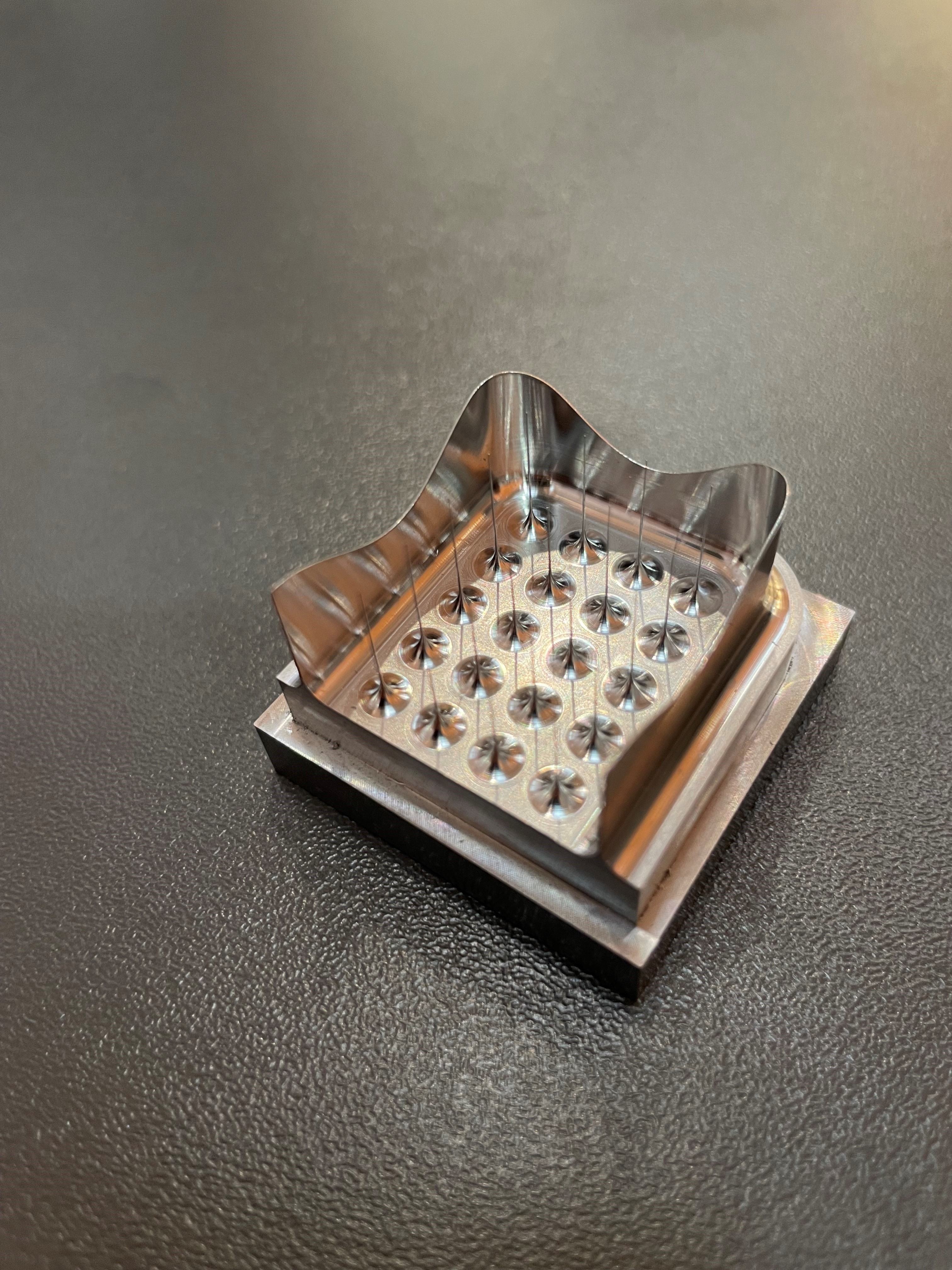

CNC machined needles of 60 μm diameter at EMO 2023Figure 9: CNC machined needles of 60 μm diameter. This part was machined live at the EMO 2023 exhibition using a Kitamura machine tool with fully-closed loop FORTiS linear encoder feedback.
