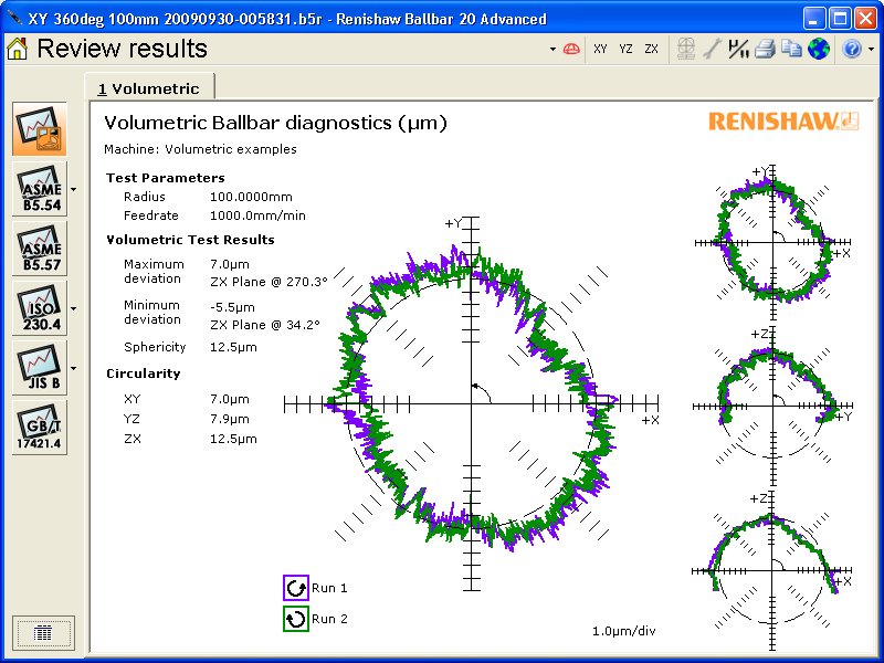

The new design also allows testing in 3 orthogonal planes through a single reference point. A single, simple hardware set up means quicker testing and the ability to produce a representative volumetric measurement of positioning accuracy. The QC20-W ballbar retains the principle of a simple CNC circular program, and powerful software. Together, these can quickly diagnose and quantify machine positioning errors including, servo mismatch, stick-slip errors, backlash, repeatability, scale mismatch and machine geometry as well as giving an overall circularity error value.

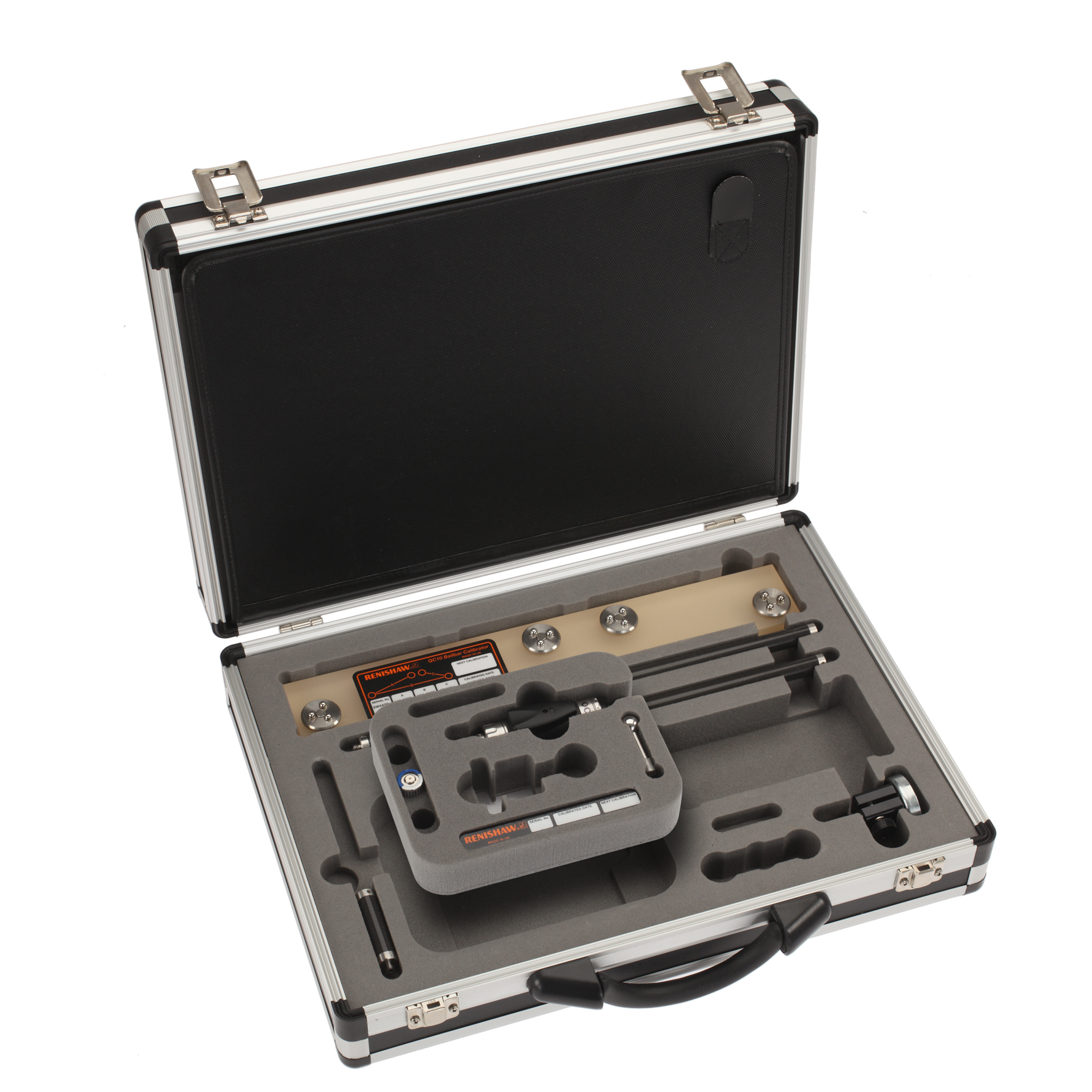

Ballbar 20 volumetric analysisThe Ballbar 20 system software has been enhanced to give even greater flexibility for testing and reporting. The QC20-W kit is supplied in a redesigned, robust system case, which includes spaces for the most popular accessories.

QC20-W upgrade kit in QC10 system caseAn upgrade kit is available to QC10 ballbar users at a very competitive price, especially if users are considering the cost of an upcoming recalibration for their existing QC10 ballbar. The upgrade kit is supplied as standard with an insert for fitting into the current QC10 case, with the new system case and additional hardware required for carrying out the new 3 plane testing available as options.

QC20-W with traceThe current world economic climate and increasingly open markets mean that the requirement to lower production costs is more urgent than ever. Minimising scrap and rework is top of many production managers’ agendas. Repair and maintenance needs to be carried out only when required, reducing direct costs and production losses due to downtime. Renishaw’s ballbar software automatically produces a diagnosis from the captured data, enabling non experts to make expert decisions. This is very useful when the availability of sufficient skilled staff is an increasing problem.
