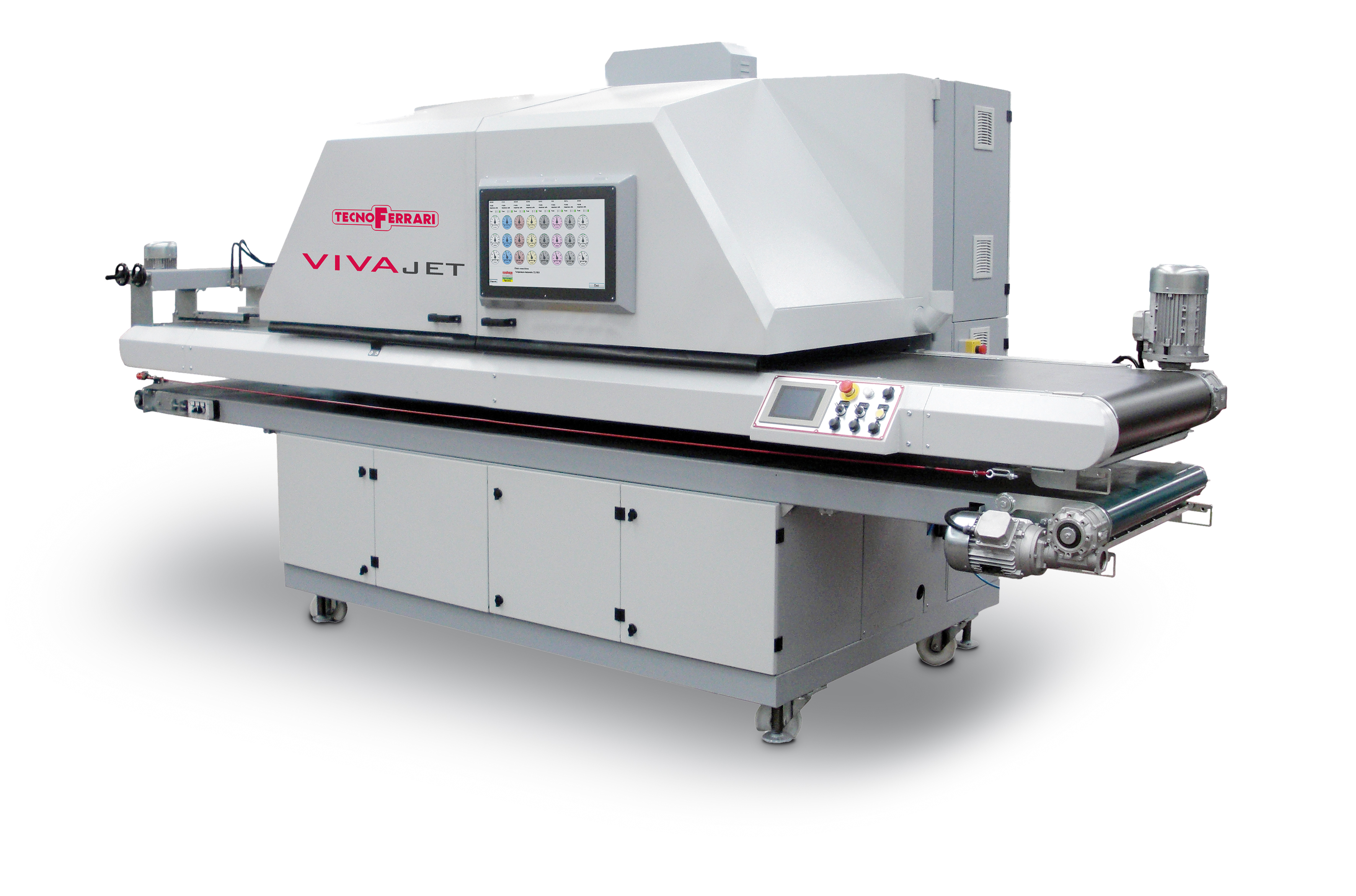

Ceramic tile printing machine (courtesy of Xaar)
Image courtesy of Xaar: a ceramic tile printing machine
Traditional ‘multiple pass' carriage-mounted printheads move on multiple axes and each axis needs some kind of encoder. The rise of HP's ‘single-pass' Pagewide and Memjet's Waterfall® processes for conventional media has resulted in a paradigm shift in printing technology, but encoder technology has application in this domain too.
