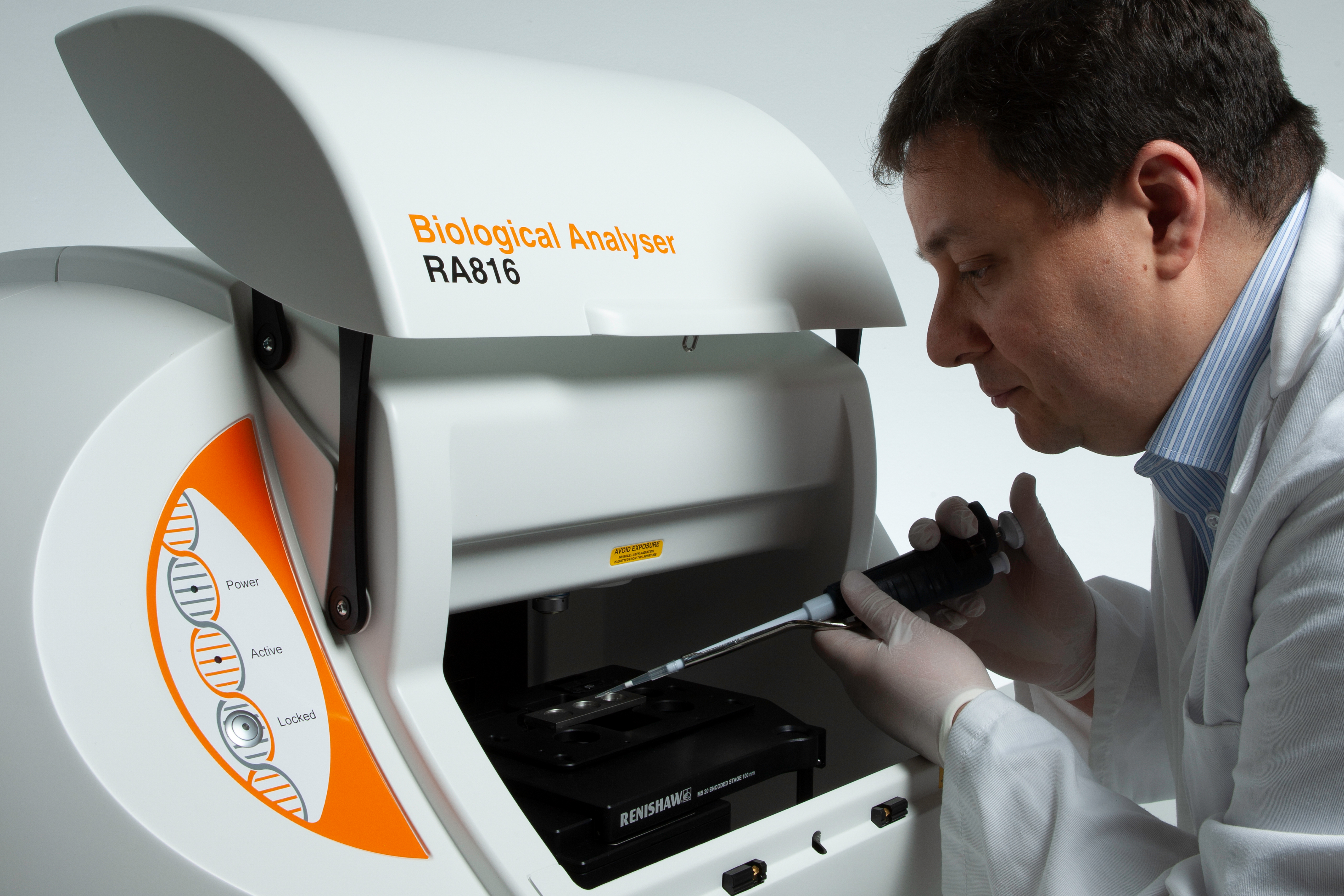

Researchers used a Renishaw RA816 Biological Analyser to identify the genetically different subtypes of brain gliomas in a neurosurgical setting. By understanding the genetics of a tumour during the operation, the clinician would be able to map out the best surgical and treatment strategy. This could help improve survival rates and treatment response of the patient.

The Renishaw RA816 Biological Analyser is a compact, benchtop Raman imaging system, designed exclusively for biological and clinical research. The system provides a practical solution for analysing biological samples with easy-to-use hardware and software and minimal sample preparation with no need for stains or labels.
