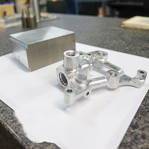

  • R&D Manco - a part such as this would have begun as a casting
    In the past, a part such as this would have begun as a casting. In every case in which R&D Manco can successfully covert the job to being machined out of solid instead, it can save the customer both cost and lead time. But doing this requires the shop to step up to a more significant role.

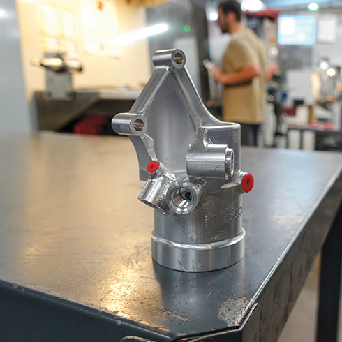

  • R&D Manco - Chris Dupre, CNC milling lead
    Chris Dupre, CNC milling lead, describes the setup stability challenge that initially affected the milling of this hogout part.
