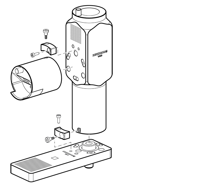

  6. For use with ACM, VA90 can be fitted to the VA11 kinematic mount and the calibration pillar fitted instead to the kinematic mount on the VA90.

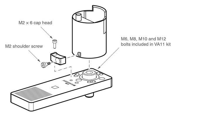

Securing the pillar / VA90
The VA11 pillar and VA90 can optionally be secured to the baseplate or each other using the supplied bracket and screws.
  1. Fix the VA11 baseplate to the bed of the CMM before securing the pillar or VA90.
  2. Position the bracket with the curved face towards the pillar.
  3. Attach the bracket to the baseplate or VA90 using the supplied M2 cap head screw and tighten with a hex wrench.
  4. Screw the M2 shoulder bolt through the bracket into the pillar or VA90 and tighten with a hex wrench. Ensure the bolt is not overtightened, it should float within the bracket so as not to affect the kinematic location of the pillar or VA90.
Fitting VA11 calibration artefact to CMM
VA90 - exploded
