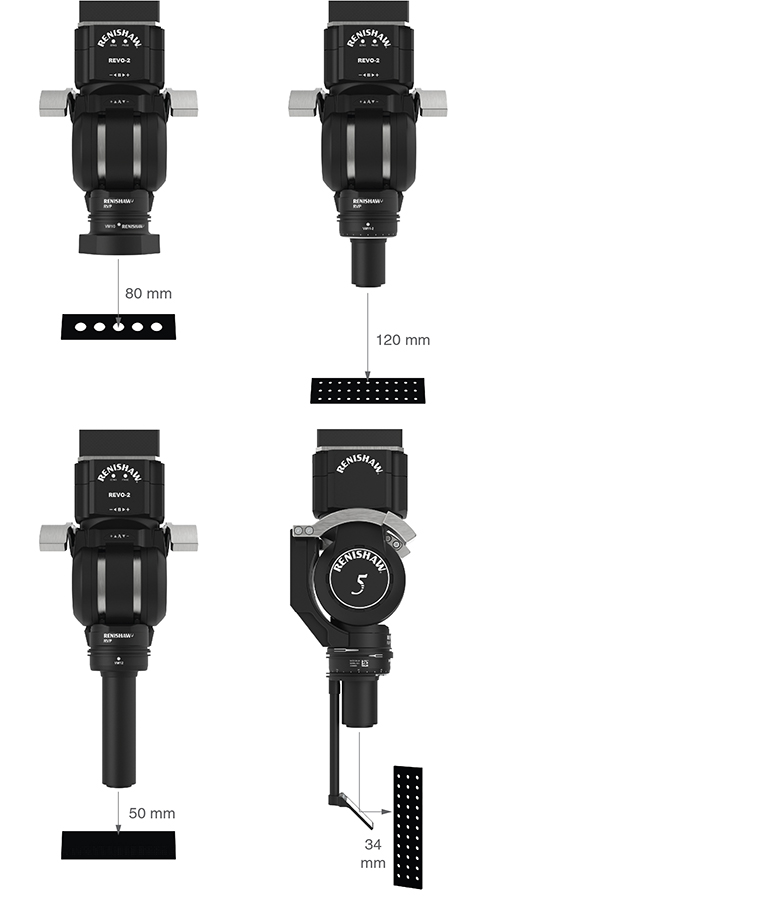

Stand-off
This is the distance between the end of the vision module and the plane at which a feature will be at the sharpest focal distance to provide optimum image capture.
RVP vision modules - stand-off

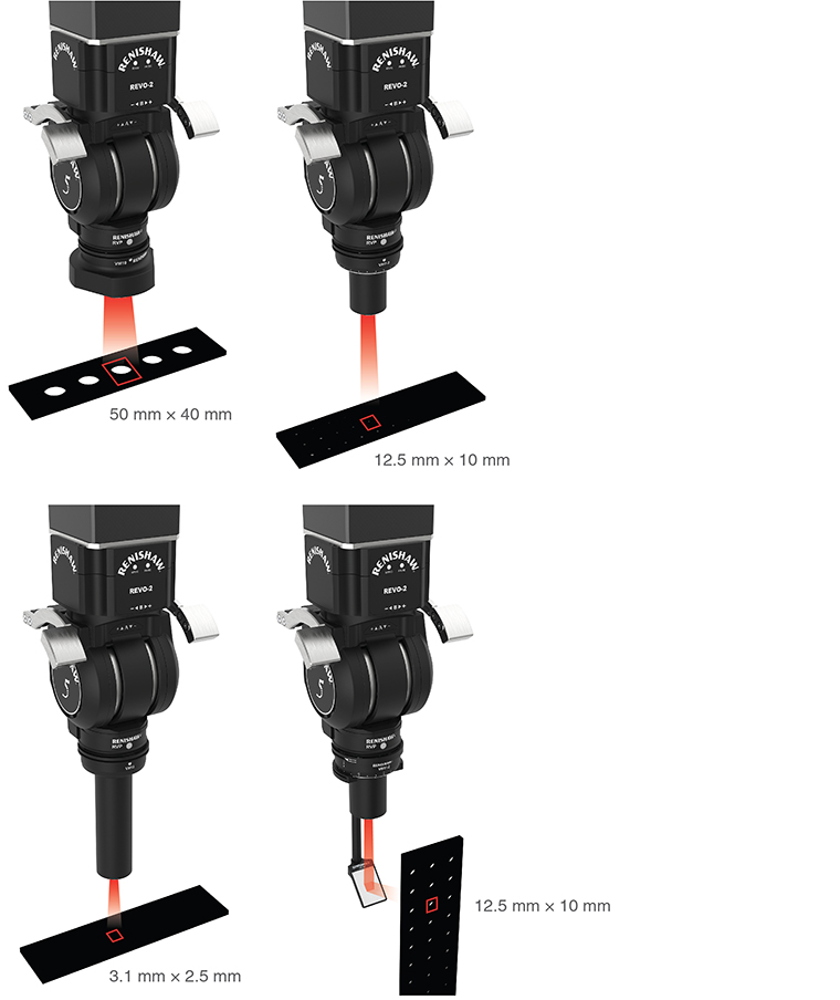

Field of view
This is the maximum size area that will be projected onto the CMOS sensor when the correct stand-off distance is used. Any feature requiring inspection with RVP must be located within the field of view to allow inspection.
RVP vision modules - field of view
