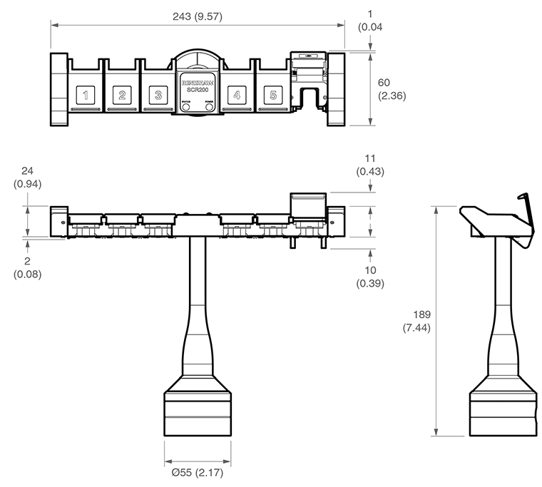

Dimensions

Weight | 0.75 kg |
Mounting orientation | Vertical or horizontal |
Mounting fixture | Single stud (M8, M10) |
Number of ports | 6 |
Repeatability of stylus change (2σ) at 50 mm | Automatic ≤1 μm |
Entry speed | Unrestricted |
Module pull-off force | 800 g maximum |
Overtravel protection | Electromechanical (5° minimum deflection) |
LED indicators | |
Power | Green |
Status | Red (flashing during probe inhibit) |
Change cycle detection | Optoelectronic beam system with Hall effect proximity sensor |
Multi-rack usage | Up to two SCR200 units (12 ports) may be connected with a special cable |
Installation
All alignment requirements and port docking co-ordinates can be established with only eight probing points. No control signals from the CMM are required.
Alignment adjustment | XY rotational only ±0.1 mm |
Docking tolerance | X ±0.17, Y ±1.5 mm, Z ± 2 mm |
Power supply / control | PI 200-3 interface |
Cable length | 20 m maximum (PI 200-3 to SCR2000) |
Cable connection | 6-pin miniature DIN socket |
