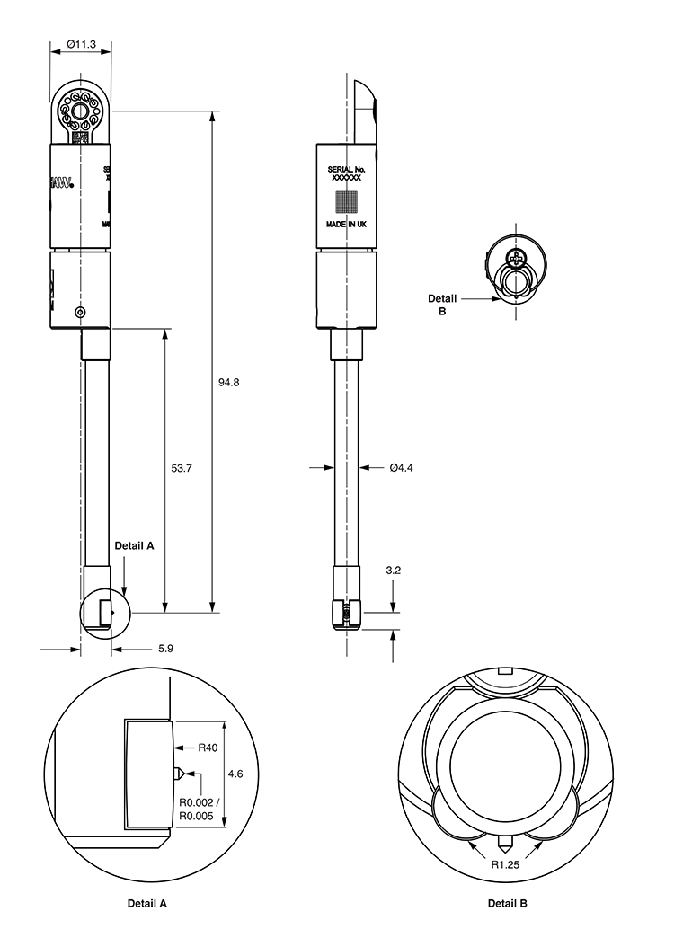

The E-series of modules use a two-part skid with a central stylus.This makes them ideal for short scans on small to medium sized bores which may be deep within the workpiece.
Typical applications
Automatic transmission valve bodies, valve seats, minimum feature access (mm): Ø9 × 52 (max. depth).
Diamond tip radius (μm)
2 or 5
Surface finish measurement range (μm)
2 μm modules
5 μm modules
6.3 to 0.05 Ra
6.3 to 0.10 Ra
Typical surface finish accuracy (of nominal Ra) *
±(10% + 20 nm)
Skid / stylus arrangement
Stylus central to two-part skid
Skid material
Tungsten carbide
Nominal stylus tip protrusion beyond skid (mm)
0.6
Minimum feature access (mm)
Ø9 × 52 (maximum depth)
Skid length / radius (mm)
4.6 / 40
Skid width / radius (mm)
5.3 (total) / n/a
Skid contact force (N)
0.15
Stylus contact force (N)
0.003
SFM / SFH knuckle adjustment range
±90°
Weight (g)
12
Resolution (nm)
1
Measurement speed (mm/s)
Up to 1
Stylus holder compatibility
SFH-1 only
Lateral scanning capability
No
SFM-E1 dimension image
