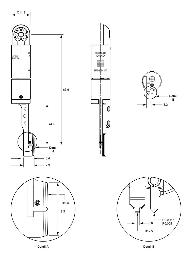

The H-series of modules employ a long skid with a large radius, which is appropriate for inspecting surface finish callouts with larger cut-off values.
Typical applications
Surface finish callouts with cut-off values of 2.5 mm and above.
Diamond tip radius (μm)
2 or 5
Surface finish measurement range *
2 µm modules: 6.3 to 0.05 Ra
5 µm modules: 6.3 to 0.10 Ra
Typical surface finish accuracy (of nominal Ra) *
±(5% + 15 nm)
Skid / stylus arrangement
Side-by-side
Skid material
DLC coated stainless steel
Nominal stylus tip protrusion beyond skid (mm)
0.5
Skid length / radius (mm)
12.5 / 125
Skid width / radius (mm)
0.6 / 12.5
Skid contact force (N)
0.2
Stylus contact force (N)
0.003
SFM / SFH knuckle adjustment range
±90°
Weight (g)
12
Resolution (nm)
1
Measurement speed (mm/s)
Up to 1
Stylus holder compatibility
SFH-1, SFH-2
Lateral scanning capability
No
SFM-H1 dimension image
