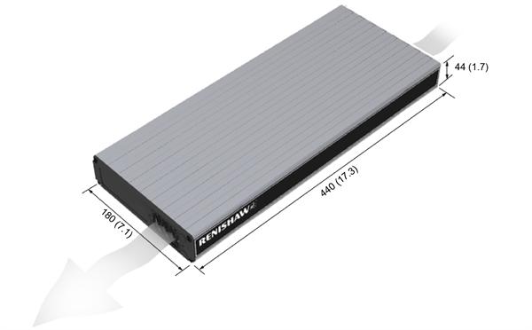

Dimensions
UCC dimensions - generic
NOTE: Dimensions in mm.
Controller dimensions and air direction diagram
The SPA3-2 unit draws air from the right hand side when viewed from the front and expels air out of the left hand side. A minimum clearance gap of 10 mm is necessary between the sides of the unit and any potential obstruction.

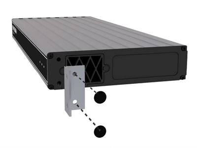

Mounting the SPA3-2
The SPA3-2 is supplied with a rack mounting kit, this allows the SPA3-2 to be fitted into a standard 19" rack.
Fitting mounting brackets
NOTE: The screws supplied with this kit are M5 × 6 mm countersink type.
SPA3 with bracket
