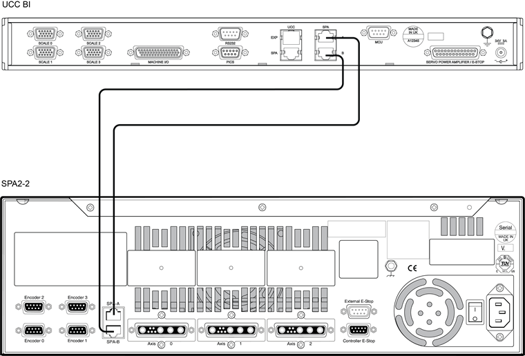

SPA2-2 comms connection
The comms link between the UCC BI and the SPA2-2 is made using two RJ45 cables (P-CA82-0017) provided in the SPA2-2 kit.
  • The UCC BI port SPA-A should be connected to the SPA2-2 port SPA-A
  • The UCC BI port SPA-B should be connected to the SPA2-2 port SPA-B
If the provided RJ45 cables are not used then the cables should be no longer than 400 mm in length, CAT 5E and shielded.
UCC BI to SPA2-2
NOTE: If 4th axis is required, the SPA2-2 will require the daughtercard interface kit: A-5402-8103.

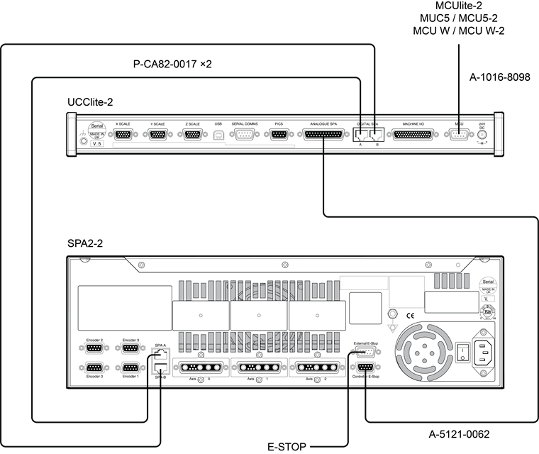

Dual UCC BI interconnection
Dual UCC BI installations require a special E-STOP cable (part number A-5208-0011). This cable has three tails, all marked with their function, and must be installed as per the diagram below.
MCU, RS232, PICS, servo power amplifier / E-STOP cable and machine I/O should be connected to UCC BI 1.
Dual UCC BI interconnection diagram with SPA2-2 and UCC S3
NOTE: E-STOP cable (A-5208-0011) is supplied only with the SPA2-2 dual, DC, and linear kits.
CAUTION: The capability to use the UCC BI in a dual SPA system or a system using absolute scales is not yet available, please contact CMM support for further information.
UCC BI to SPA2-2
NOTE: The connection between the UCC BI's servo power amplifier socket and the SPA2-2's controller E-STOP plug is made by cable A-5121-0062. This cable is provided with the SPA2-2 (A-5402-8300).
UCC BI to SPA2-2 - with MCU and E-STOP
