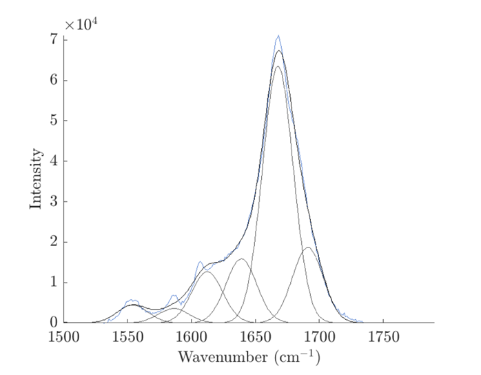

To compare proteins in the inner and outer cortical layers of the feather shaft, Christian fitted six curves to the amide I band and compared the ratio between the β-sheet protein peak at 1668 cm-1 and the 1613 cm-1 polypeptide side chain peak. This revealed that across the four investigated bird species, the concentration of protein with β-sheet conformation was greater in the inner layer compared to the outer layer. This finding supported Christian's additional work, where he identified for the first time that the Young's modulus value, E, a measure of bending stiffness, was higher in the inner layer than the outer layer. This suggested that the inner layer is more resistant to bending, whilst the outer layer is more resistant to torsion.
Raman spectra of bird feathers
An example fit of data from the Amide I region. The blue line is the data recorded, the black line is the fitted curve from six component Gaussian functions, shown in grey. The spectrum is from the outer layer of the dorsal part of the first primary (P1) from the mute swan (C. olor), taken at 40% length from the base of the calamus. The R2 value of the fitted curve is 0.9898.
