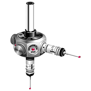

PH5
A fixed probe head that is shank mounted for fitment onto a CMM
The PH5 is a compact probe head that is capable of carrying up to five TP2 or TP6 touch-trigger probes simultaneously, or one TP200 strain gauge probe.

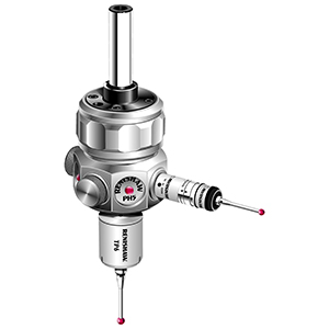

PH5/1
PH5/1 is a five-way fixed head with 'B' axis indexing, overtravel adjustment
The PH5/1 probe head is similar to the PH5 model. It is a compact unit that is capable of carrying up to five TP2 or TP6 touch-trigger probes simultaneously, or one TP200 strain gauge probe.
