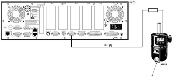

2-wire touch-trigger probe system
UCC2 2-wire touch-trigger probe system

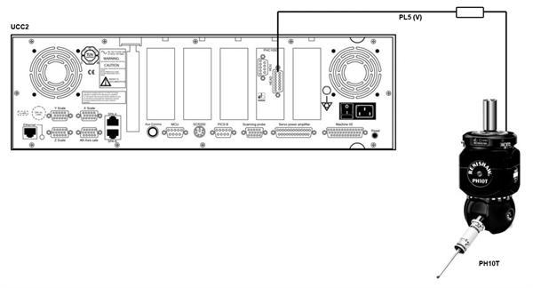

PH10 probe head and 2-wire touch-trigger probe system
PH10 probe head 2-wire touch-trigger probe system

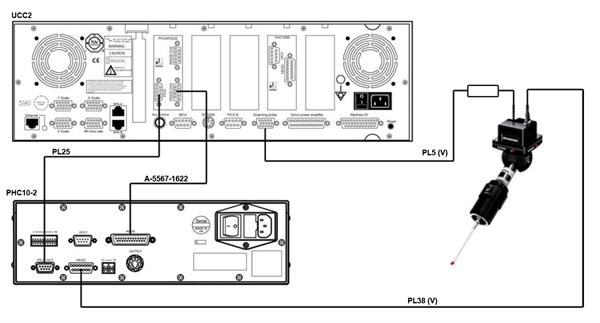

PH10 probe head and multiwire probe system using external PHC10-2

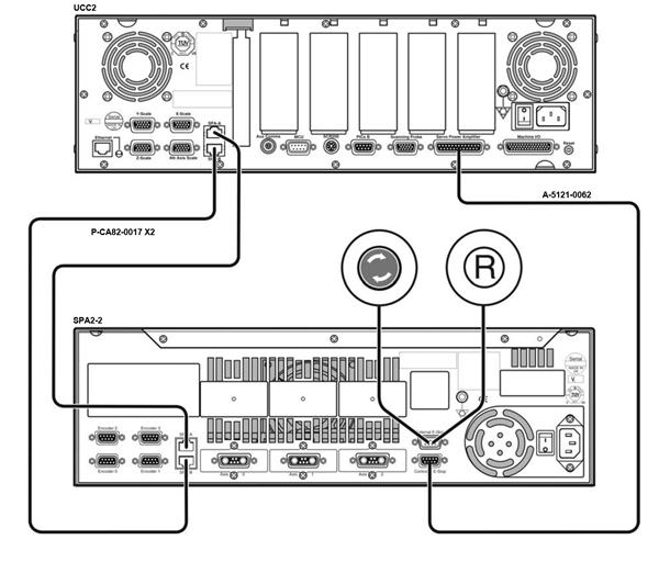

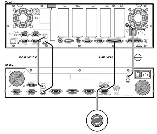

UCC2 and SPAlite
UCC2 and SPAlite
UCC2 and SPA2-2
UCC2 and SPA2-2
