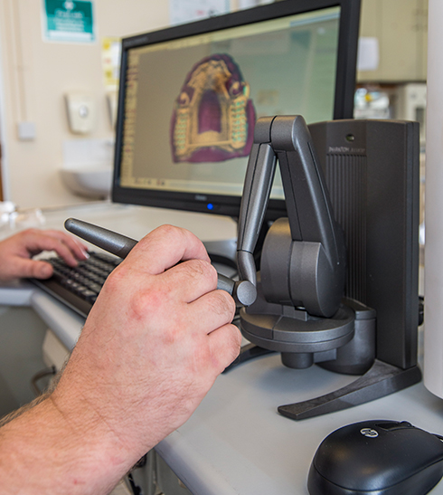

The number of design packages is now growing, however, the options are still limited compared to crown and bridge and implantology. In this study, to give maximum flexibility the team used Freeform™ software coupled with the Sensable® Haptic Device, now owned by Geomagic® and sold under the name Touch™ X. This coupled with a Renishaw DS20 optical scanner gave the full suite of design tools required.
Once the master model was scanned it was imported directly into the Freeform software. From here the operator can start to identify the insertion axis and block out undercuts. The undercuts can be varied to allow for tighter or looser retention. Also at this time, clearance from the gingiva can be dialled in to accommodate acrylic thickness.
Following this the design process can really start in earnest. A full suite of indirect and direct retainers, major connectors and acrylic retention features can be designed into the denture.

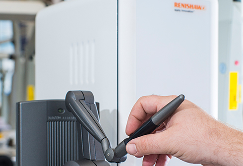

Using the Haptic arm can be a little alien at first but soon becomes second nature and the user will be quickly designing occlusal rests with intricate reciprocal and retentive arms.
Acrylic retention can also be designed-in using a variety of mesh options and surface modifications, just as for a traditional RPD.
