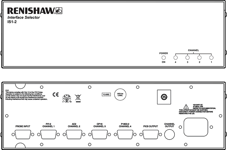

Automatic switch for use with multiple sensor types
  • IS1-2Identifies probe type and switches output to correct interface
  • 4 separate channel outputs
  • Compatible with SP25M, SP80, SP600, TP7M, TP2*, TP6*, TP20* and TP200*
  • Compatible with ACR1 and ACR3 autochange systems, PH10M PLUS / PH10MQ PLUS motorised heads and PICS
* Do not require a programming module
IS1-2 front and rear panels
