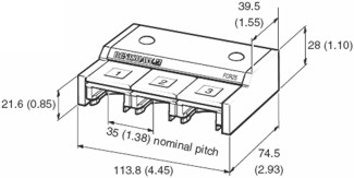

FCR25 and FCR25 TC
FCR25 dimensions
FCR25-L3 and FCR25 TC-L3 (three port)
FCR25-L3 Abmessungen

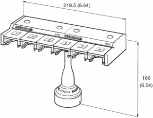

FCR25-L6 (six port)
FCR25-L6 Abmessungen
