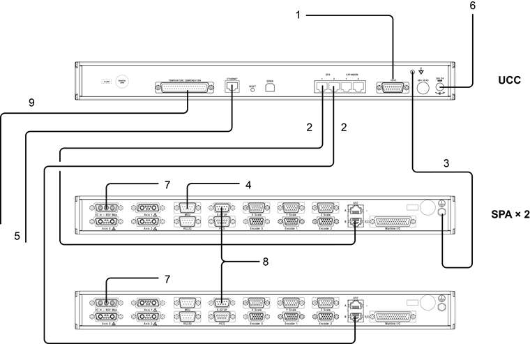

System connection
Earth bonding scheme
Generic UCC and dual SPA earth bonding scheme
Installation for 4 - 6 axes
2 x SPA and generic UCC interconnection diagram with TEC
Key
Description
Key
Description
1
Head cable
6
24 V power supply (supplied)
2
CAT 5 300 mm cable (supplied)
7
25 V - 80 V power supply (not supplied)
3
16 / 0.2 mm earth connection
8
E-STOP link cable (supplied)
4
MCU connection
9
TEC input
5
CAT 5 ethernet cable (5 m cross-over cable supplied) to host PC
The head and CMM system are operated through UCCserver which uses I++DME command protocol to communicate between the system application software and the UCC.
Full 5-axis scanning capability is achieved through interaction between the UCC, the head and the SPA3, to co-ordinate all the motion and metrology aspects across the three CMM axes and the two head axes.
