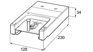

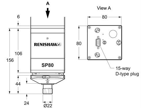

System dimensions
SP80 with SH80
SP80 with SH80K
KM80
SCP80 / SCP80V
IU80
NOTE: Dimensions in mm (in).
