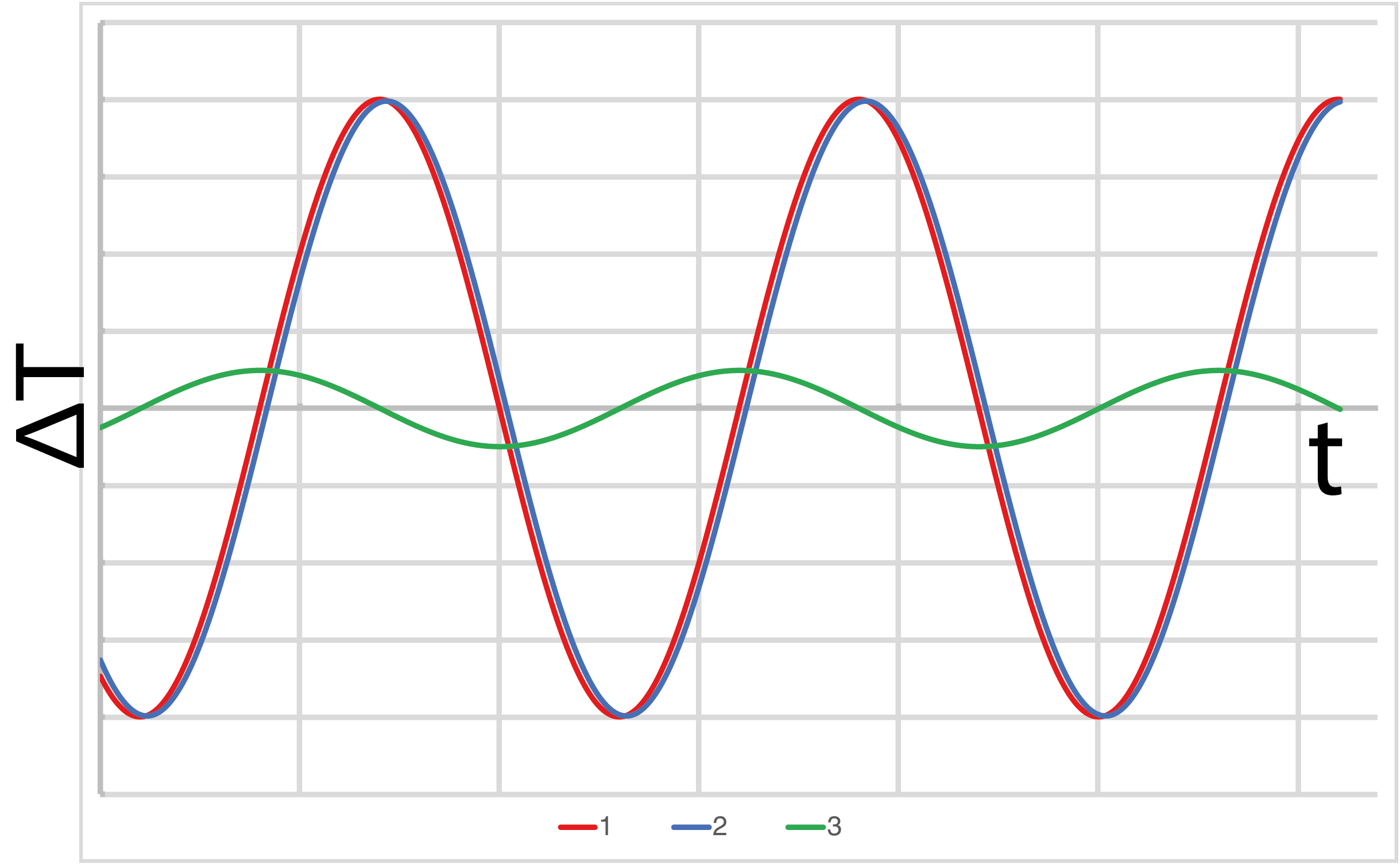

A floating linear encoder scale is installed on each axis (X, Y and Z). The stainless steel scale is largely independent of the granite substrate and rapidly responds to changes in air temperature due to its high thermal conductivity and low thermal mass, which is significantly lower than the thermal mass of the granite bed. This leads to a maximum expansion or contraction of the scale over a 3 m axis of approximately 60 μm. This expansion can produce a substantial measurement error which is difficult to compensate due to its time-varying nature, as shown in figure 2.
Substrate mastered scale is the preferred choice in this case: a mastered scale would only expand with the coefficient of thermal expansion (CTE) of the granite substrate and would, therefore, exhibit little change in response to small oscillations in air temperature. Longer term changes in temperature must still be considered and these will affect the average temperature of a high-thermal mass substrate. Temperature compensation is straightforward as the controller only needs to compensate for the thermal behaviour of the machine without also considering the encoder scale thermal behaviour.
