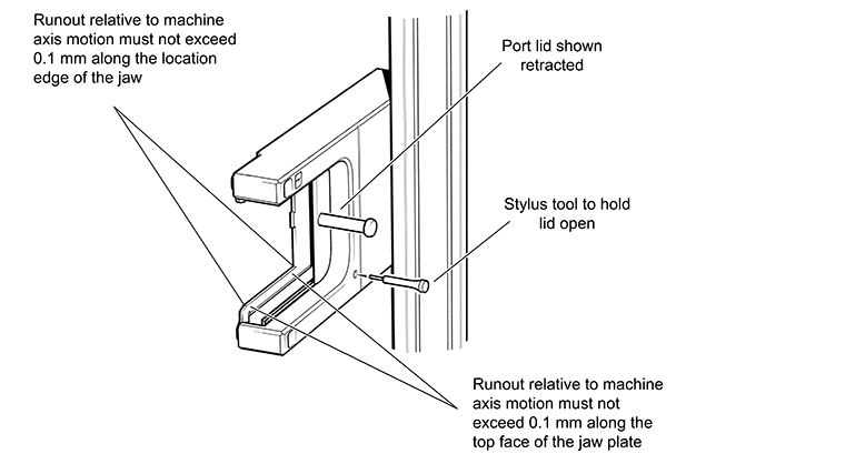

Alignment of the SCP80(V) to the CMM axes
Alignment of the SCP80 to the CMM axes
The alignment of the SCP80 to the CMM axes should be checked to be within the limits shown below.

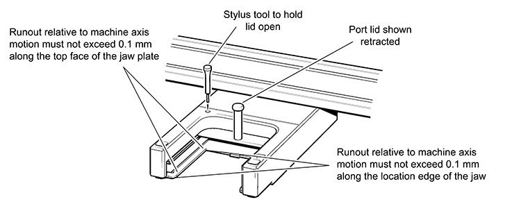

Alignment of the SCP80V to the CMM axes
The alignment of the SCP80V to the CMM axes should be checked to be within the limits shown below.
