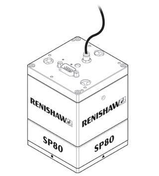

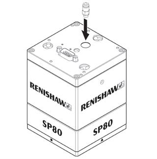

Installing SP80 / SP80H air purge option
Install the air purge connector by following the steps detailed below:
1. Remove screw as indicated.
2. Screw the supplied air fitting (P-MA01-0043) into the hole.
3. Fit the air pipe to the air fitting.
