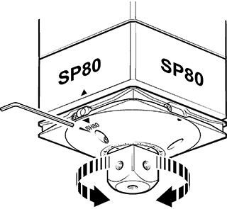

Styli orientation
The stylus cluster can be rotationally adjusted to its required position by adjustment of the 5-way cube as follows:
  1. Releasing the rotational clamping screw using the 2 mm across flats hexagonal key.
  2. Rotating the stylus cluster to the required position.
  3. Tighten the rotational clamping screw to torque of 1.0 Nm.
Rotational stylus adjustment:
SH80 rotational stylus adjustment
