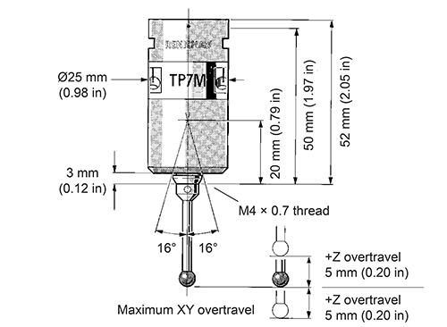

Dimensions

Weight | 85 g (3 oz) |
Maximum extension (if on a PH10 PLUS series head) | 200 mm (7.87 in) |
Maximum recommended stylus length (M4 styli range) | 150 mm (5.91 in) stainless steel 180 mm (7.09 in) GF (carbon fibre) |
Mounting method | Multiwired autojoint |
