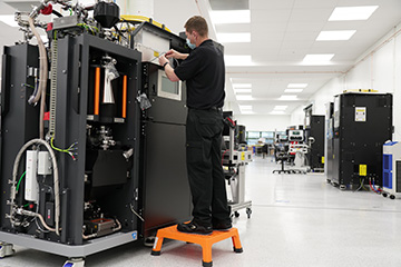

  • RenAM 500Q machine assembly at Miskin
