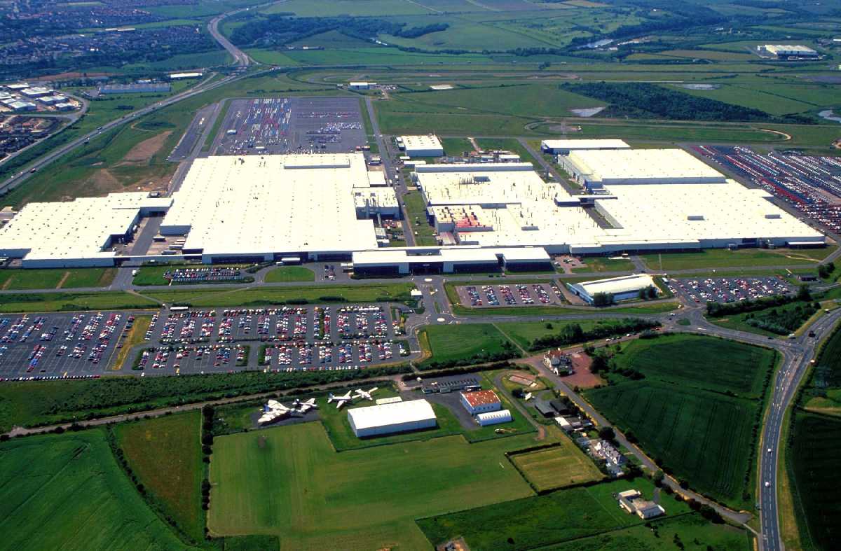

Nissan plant site aerial shot [gen]
Nissan’s Sunderland plant – main suppliers are grouped on the periphery of the site so all parts are made in-situ
