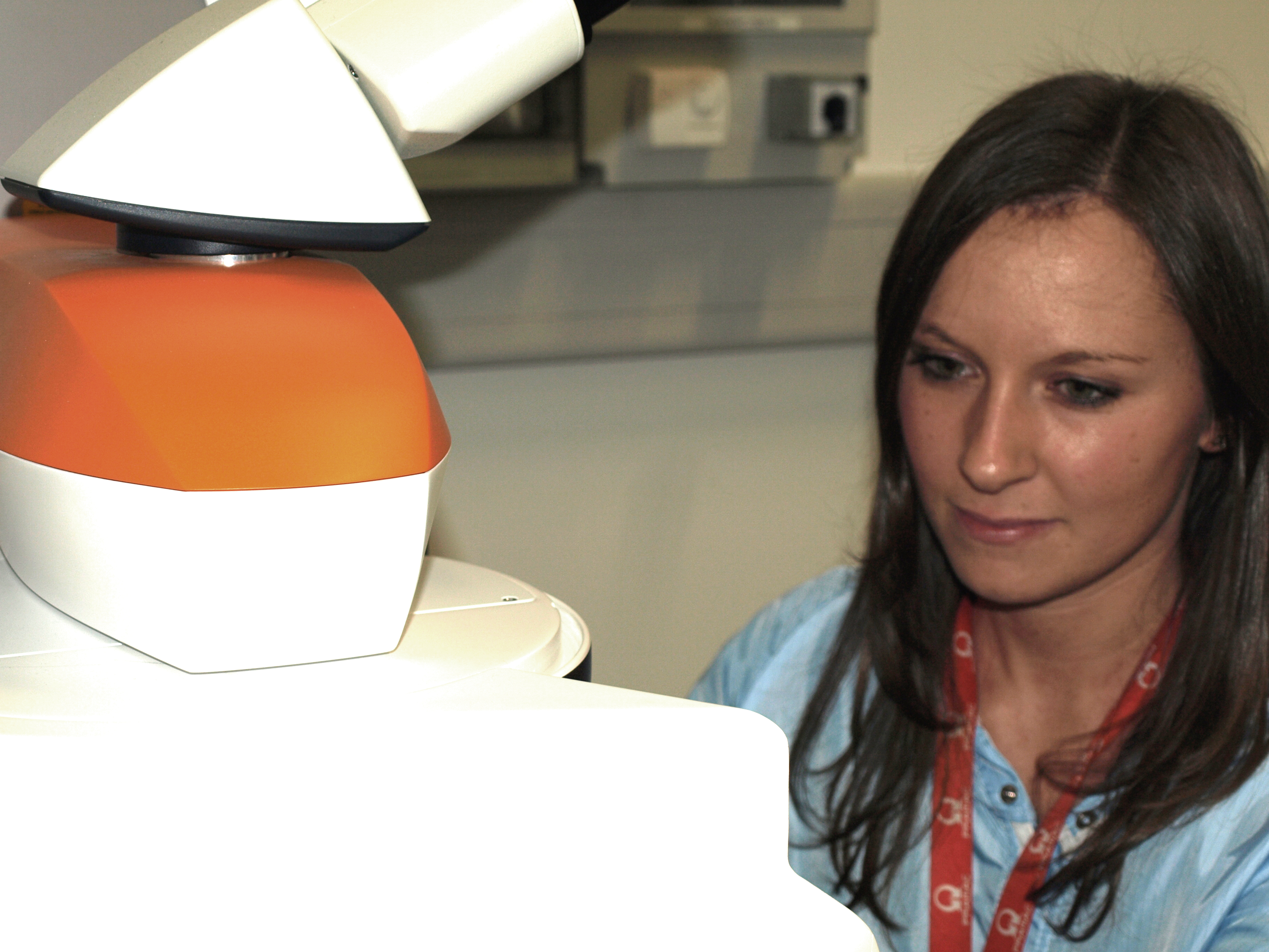

Raman analyses in the QC laboratory are performed using an inVia Raman microscope, with 20 panels being withdrawn from production for test every 15 days, just after first deposition of the Si- Si thin layer. Each panel is then cut into 13 square samples, and the crystalline fraction of each sample is measured at three different points. This process has been semi-automated with Renishaw's WiRE software custom analysis package (CAP), allowing a range of standardised procedures to be developed, each one efficiently automating part of the QC operation. CAP’s user-friendly interface has also enabled efficient multi‑operator use.
