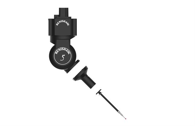

To manually mount or remove the probe from the REVO head you need to:
  1. Align the front sides of the head with the probe (look at the "Renishaw" engraving on the side of probe or alignment marks as applicable).
  2. Carefully align the probe to the head, allowing the magnetic attraction to gently connect the kinematic joints.
  3. Gently rotate the probe to ensure correct location.
  4. To remove, securely hold the probe and gently tilt to break the kinematic joints.
