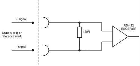

Scale input signals to be to EIA specification RS-422:
Scale input
UCC T3 input circuits for CMM readhead - scale and reference mark inputs
