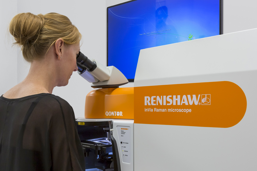

inVia can analyse all the key material types: organic and inorganic; crystalline and amorphous; solids, liquids, and gases. Its high sensitivity makes identifying all the key battery components easy: carbon materials, metal oxides, polymers, electrolytes.
In situ measurements
Use inVia with a wide range of sample chambers, electrochemical cells and inert gas glove boxes. Raman data acquisition on inVia can also be triggered from devices such as potentiostats, enabling in situ and operando measurements.
The benefits of spectroscopy
- Getting data, without damage: Lithium-ion battery components can be altered or damaged by high laser power densities. With Renishaw's line-focus laser illumination technology, power densities are reduced but total laser power is retained, so you can collect high quality data rapidly, and with confidence.
- Sensitivity: inVia's high sensitivity and high spatial resolution enable you to detect materials even if they are present in low concentrations, such as binders.
- Correlated information: Combine inVia with an atomic force microscope and get not only chemical information from Raman spectroscopy, but also correlated surface topography information from AFM.
